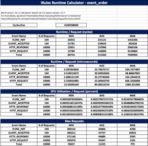

Problem this snippet solves: This script auto-generates the iRules Runtime Calculator Excel spreadsheet by connecting to BIG-IP, collecting the iRule and its stats, and then using the XlsxWriter module to populate the spreadsheet. Tested on BIG-IP 12.1, 13.1, 14.1, 15.0 with python 3.5, 3.7 from Windows 10 and MacOS Mojave Article details if interested. Screenshots: How to use this snippet: usage: runtime_calc_v2.py [-h] host username rule Tested this on version: 13.0 Download here: GitHub Gist1.1KViews2likes0CommentsPython BigREST ucs save and download
