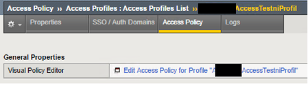

Hi, I'm having some troubles in visual policy editor ... I've copied the access policy, and I named it Abc_AccessTestniProfil. But when I open Visual Policy Editor, path to the Access Policy is completely different (pictures bellow). Has anyone already had a problem with this? Is there any chance to change the path in visual policy editor? SW version: 12.1.2 HF2. Regards, Spela261Views0likes1Comment
