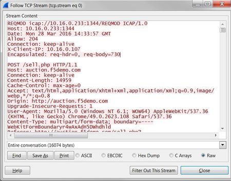

Dear all, Working on a integration with F5 ASM with Mcafee Virusscan for storage (ICAP server) and the server keeps sending me HTTP response code 400 Bad Request. Below the configuration and Wireshark output and logs. Following is the response code 400 In ASM request log the following is being logged This is the ouput of that log F5 is configured with /REQMOD as stated in the documentation I believe we are using the right solution for ICAP scanning Mcafee Virusscan for storage with ICAP AV scanner enabled version 8.8 hotfix 4 and Enterprise for storage 1.11.6KViews0likes14CommentsInstalling McAfee Agent for SSL Decryption at F5
