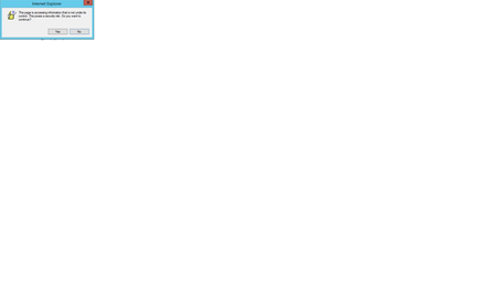

Hello, We recently enabled SSL offloading for an application. Intermittently the users are receiving the warning error shown in the picture by Internet Explorer when accessing certain forms. Do any of you have bumped before with something like this. I have the feeling that the application is calling a different domain name in the back-end to reach information and therefore Internet Explorer is warning about it but I would like to know if there is a way to prevent this by using a URI re-write or any other method. Can I get some recommendations on where to continue looking or maybe a way that you have used to fix this? Thank you.330Views0likes1Comment
