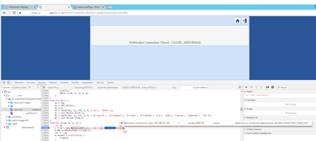

I am having an issue with rewriting my WebSocket connection. Let me explain my scenario, and then I will explain the issue I am experiencing. On my Internal network (192.168.252.x) I have a HTML5 gateway device(252.100), that is used to establish an HTML5 RDP session. This component is setup correctly, from the internal network I am able to log into the web based interface and successfully establish an HTML5 based RDP connection from my HTML5 gateway device (252.100) to my target machine 252.101. What I am trying to accomplish is to do this HTML5 RDP connection going through the F5. From the webtop, my user will click on a portal access link. This portal access link takes the user to the web based front-end of my HTML5 gateway device via and https webpage. My user is able to successfully go through the webtop, and log into my web front end. The issue occurs when starting the HTML5 RDP session from the webtop. My HTML5 proxy machine is throwing an error saying Websocket closed. Tracing the network traffic between all components, there is no traffic flow from the HTML gateway and the Target machine, and no traffic flows into the HTML gateway. This is due to the fact that the Websocket is not being rewritten by the F5. I will try to attach an image with the Chrome dev console that shows this websocket address: In short: when a new websocket is created I get the following: WebSocket connection to 'wss://192.168.252.100/myservice?mypage.hsl_mode=DIRECT&servicename_name=encodedlinkname failed: Error in connection establishment net::ERR_CONNECTION_TIMED_OUT. What I would expect to see is not the direct Internal IP address of the HTML5 gateway but some External IP from the F5 since the websocket should be rewritten by F5. My External net address is 192.168.210.x. I am testing from 192.168.210.100 and my F5 External self IP is 192.168.210.22. So I would expect to see that the websocket address would the External SelfIP. I have attempted playing around with the HTTP profile, Redirect Rewrite settings (None, All, Matching, and Nodes). But this didn't seem to help. I have also tried creating a WebSocket profile and tested all the Masking settings, (Preserve, Unmask, Selective, and Remmask) Also no dice. I have tested quite a few settings on the other profiles as well without any luck. Any suggestions would be helpful. As a side note: I was able to get this successfully running on Big-ip 11.4. With the same configuration, I am not able to get this working on our newer 12.1 implementation. I am also currently unable to observe the 11.4 websocket creation behavior as this VE install has eaten itself while trying to do a version update.. But that is another story.2.4KViews0likes9CommentsAPM :: VMware View :: Blast HTML5
