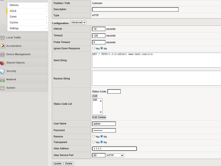

Hello Everyone, I was testing some experimental config for DNS/GTM where the health monitor does not monitor the pool members but a specific IP address configured in the "alias" and it does not work as the error says bigd timeouts to report the state. For LTM http/https health monitors the "alias" option works but not for gtm/dns. I think I discovered a bug as this is rare use case to not monitor the pool members themselves. I have changed the ip to 1.1.1.1 just for the picture screenshot 😄 Also in the logs after gtm and big3d is enabled I see the logs below and too bad that F5 DNS does not have monitor debug like LTM to just enable a debug for a monitor and not the entire box. ----- Will not probe x.x.x.x:80 ( in DC /Common/niki-dc because will be done by other GTM (<unknown>:<unknown>) Unable to identify which gtm server represents the local device196Views0likes1Commentwhat will happen if local gtm/dns disable the sync with other gtm/dns sync group?
