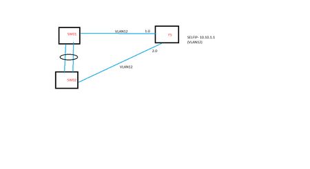

1 TopicF5 not support cable failover? or how can be configure
As mentioned in picture, If we connect F5 with two different switches using port 1.0 & 2.0. Both ports having same access vlan and they will be un-tagged with same vlan VLAN12. Now seems F5 not compatible with cable failover as same selfIP , F5 advertising to switch using interface 1.0 and 2.0. Which creating switch STP loop and due to STP default behavior, One interface switch put in error disabled state. Is any way on F5 to support cable failover, incase one cable goes faulty, traffic will sent to switch 02 switch another cable. seems F5 incompatible here and TAC guys don't have answer.655Views0likes3Comments
