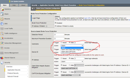

Ver. 14.1 ASM Policy framework: ASM OWA Policy Trying to provide a soft lockout to user logins to OWA when they failed to auth 2 times and they have to wait 15 minutes and when we create the Brute Force Protection for the start page, we are seeing that UserID only has Alarm, Alarm and Client Side Integrity, and Alarm and CAPTCHA. Preferably, we would want the option to Alarm and Block when users keep hitting the VIP. NOW, we can provide some softlockout features if we also change the IP address action with Alarm and Blockm but the userID is the option we were hoping to provide the block at. With UserID set to Alarm and IP address to Alarm and Block, dont feel like we are getting the full soft out function as we want to monitor user login activity. Thoughts?643Views0likes2CommentsOWA bruteforce protection with ASM
