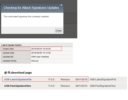

Hi, Regarding ASM Update Signatures When I Check signatures update in ASm its popup "The Most recent signature file is already installed" Create is 2016-08-04 But in page shows latest signatures ASM Latest Signatures file 8/11/2016. Please advice ...339Views0likes2Comments
