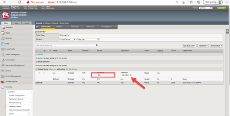

Can anyone help me to configure my AFM, what i want is to reject/drop all client that want to access my VS, i already tried configuration but it still not working on my end, btw i'm using VPN to change my IP base on the country/region. Please see the configuration on my screen shots. Thank you in advance guys! Regards, RenatoSolved735Views1like3CommentsSSH Proxy configuration
