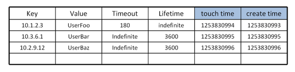

So, if you have a table that looks like:
and you run:

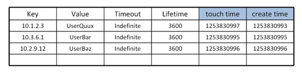

table set 10.1.2.3 UserQuux indefinite 3600
then you end up with:

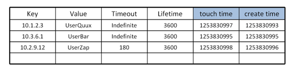

The timeout and lifetime both got updated because the data was updated. If you then ran:

Sometimes you might want to update the value and not touch the existing timeout or lifetime values, even though you don't know what they are. By specifying a 0 for either the timeout or the lifetime, or by omitting the lifetime, that parameter is not changed even if the value is updated. So if you had the previous table and then ran:
table replace 10.2.9.12 UserZap 180 0
you would get:
You can see that the entry's value and the timeout were changed, but the lifetime was not.
