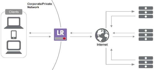

In this solution, a LineRate instance is configured as a forward-proxy as shown in the figure below. The LineRate proxies HTTP requests from clients in the corporate/private network to servers on the public Intenet, and relays the responses from the servers to the clients. Please refer to our Product Documentation for the configuration guide [3].
Here is the script. When a client in the corporate/private network sends a request, the LineRate checks if the requested resource is a favicon (line 3 and 10). When the response comes back from the server on the Internet, it checks the Content-Length response header value [4]. The LineRate passes the favicon smaller than a predefined threshold (line 4 and 13): Otherwise, it discards the data and sends back 403 error message to the client.
