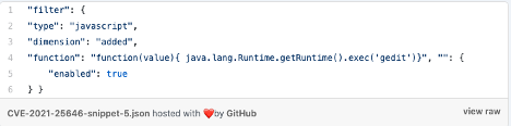

Druid offers the ability to execute JavaScript at the server without restrictions. Out of concern for security, JavaScript is disabled by default. However, a remote attacker can bypass this restriction by sending HTTP request containing crafted JSON data in the request body, which may lead to the execution of arbitrary code with privileges of the vulnerable server.
Figure 1:  Attack vector example
