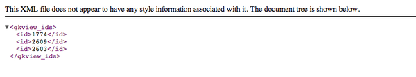

GET /qkview-analyzer/api/qkviews
Will show us a list of the qkviews that we have in our account:
This is a sample, and there is a special QKView that isn't show in the listing, but that you should always have in your account, a QKView with an ID of 0. It's a sample QKView that we allow everyone access to in order to see how iHealth works with requireing you to upload anything of your own.

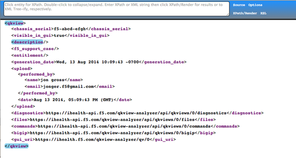

So let's pick QKView 0 and load it up. We'll see some details about that QKView:
GET /qkview-analyzer/api/qkviews/0
Feel free to poke around. At the bottom of the listing are some "discovery" URLs. Load them up in your browser; there is a ton to explore here, and you can get an idea of the kind of data you can work with without writing a single line of code. Code will come later, as you'll need it for things like adding to your QKView collections, and modifying existing QKView entries, which are tricky to do with just a browser.
