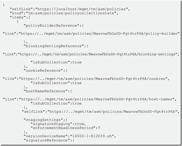

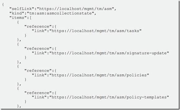

I love these articles, but two points: 1) The embedded examples are ASM related, not self-IP related. 2) You will only see the allowService option if it is set to something other than 'Allow none', where 'Allow none' is the default value if creating a self-ip on a vlan other than 'internal' or 'external'. - Andrew_Le_12873
Yeah, the screenshots don't match the description for it. Also, at least in version 12.0, you can now use PATCH method to change just one attribute from an object, leaving the other attributes for it untouched. - JerryMac_150114Historic F5 AccountThanks Robert for pointing this out. I started at it for sometime before realizing the example has nothing to do with modifying self-ip which is why I wound up here.

The screen shots don't match the code making this all but useless to me. - Andrei_379458Historic F5 Account
