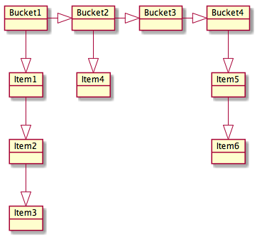

To achieve more parallelism in a concurrent environment data structures can be designed to allow localized locking instead of global locks around the structure itself. If discrete areas can be identified only those specific locations need be locked allowing other threads access to the remaining structure for read and/or write. For instance, a hash table is often implemented as an array of buckets where each bucket can then store multiple items in a list. With this example each bucket can be locked without denying access to any other bucket.
It happens that is precisely how
boost::unordered_map
was implemented. A structure analogous to this:

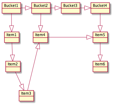

With some clever extensions and a wrapper layer for locking, individual bucket locking was achieved and a robust concurrent data structure created. However, the newest boost libraries changed their internal implementation rendering bucket locking unsafe and now an area of instability. The new implementation is a structure analogous to this second diagram:
Notice that each tail item actually links back to what should be the head of the next bucket. The implementation is now a single linked list. This change allows the data structure to walk from one bucket to the next invalidating the wrapper’s assumed bucket locking. The traversal from Item3 to Item4 in the diagram now means one process or thread will access data which could be “locked” by a completely different process or thread. This discovery took multiple engineers writing code to reproduce the issue, using resources for reproduction, analyzing code and core files, and days of otherwise fruitful development spent. While the issue was fixed it was introduced because of an assumption about the static nature of a library’s internal implementation.
