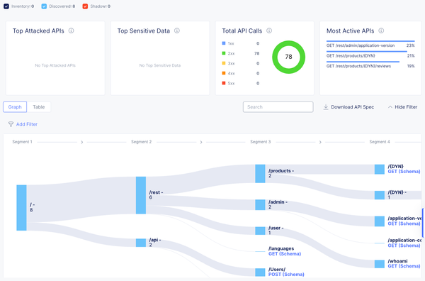

You can do this by putting your client traffic through an engine that offers this, like F5's Distributed Cloud (or F5 XC).  With F5 XC, you can build a list of the URIs and their metadata and generate a threat assessment and data profile of the traffic it sees.
Interactive view of API calls

If we can gather the traffic and make it available to the XC API Discovery process, generating the above graphic for your traffic is easy.

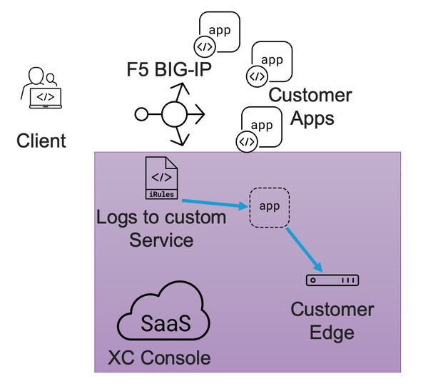

Replaying, or more accurately, "mimicking" the traffic can be done using a log process on the main proxy - BIG-IP or nginx are good examples, but any would work - and then sending that logged traffic to a process that will generate a request and response that traverses an XC Load Balancer.
API Discovery traffic flow
This diagram shows using an iRule to gather the request and response data, which is then sent to a custom logging service.  This service uses the data to recreate the request (and response) and sends that through the XC Load Balancer.
Both the iRule and the Logger service are available as open-source code here.
If you're interested in deploying this, F5 is here to help, but if you would like to deploy it on your own, here is a suggested architecture:
Deploying the logger as a container on F5 Distributed Cloud's AppStack on a Customer Edge instance allows the traffic to remain within your network enclave.  The metadata is pushed to the XC control plane, where it is analyzed, and the API characteristics are recorded.

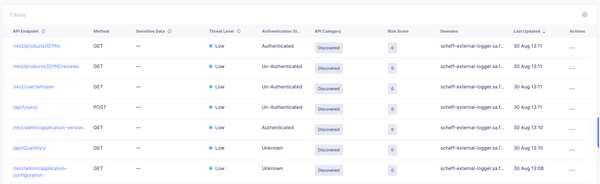

The analysis provided in the dashboard is invaluable for determining your threat levels and attack surfaces and helping you build a mitigation plan.
From the main dashboard shown here, the operator can see if any sensitive data was exposed (and what type it might be), the threat level assessment and the authorization method.  Each can help determine a course of action to protect from data leakage or future breach attempts.

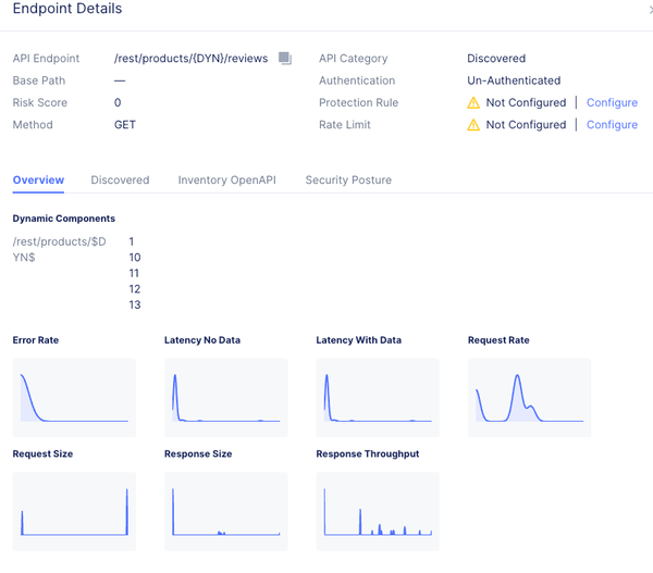

Drilling into these items, the operator is presented with details on the performance of the API (shown below).
endpoint details
