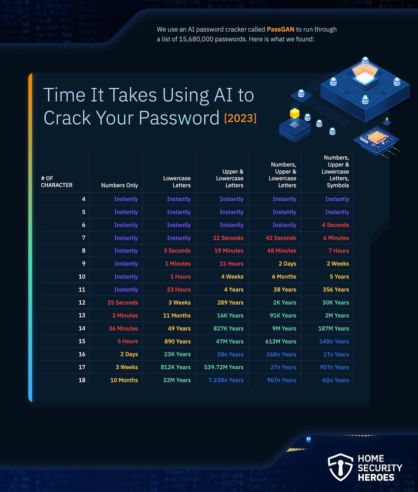

A study on AI’s ability to crack password
We all have been listening a lot about AI and its capability to do various things. Latest addition to that is cracking password.
A latest study published by Home Security Heroes shows that password cracking tool PassGAN can crack 51% of all common passwords in less than one minute, 65% in less than an hour, 71% in less than a day, and 81% in less than a month. Reason behind such a speed is  that, instead of having to run manual password analysis on leaked password databases, PassGAN is able to “autonomously learn the distribution of real passwords from actual password leaks.”
Here are the stats produced by Home Security Heroes on how much time it takes to crack the password using AI.
Result is really alarming. In my opinion time has come that all applications should enforce a password which
  • Use at least 15 characters.
  • Have at least two letters (upper and lower-case), numbers, and symbols in the password.
  • Avoid obvious password patterns, even if they have all the required character lengths and types.

    On the subject of password strength, I think I'd be fine with 12+ mixed case letters - I'm not going to be around in ~300 years.. of course there is the argument that compute speed is going to continue to improve, and 289 years could quickly become 5 minutes but then where do you draw the line? 2Bn years could become a week, etc.. I think it's too soon to say how fast crack time is going to decrease.
    One thing that is indisputable though - 8 characters with a mandate for a single number and punctuation character definitely isn't enough in 2023.
  • Thanks Aaron, you are obsolutely correct. We dont know how fast things can change, that's the only reason I mentioned 15 days, so that some buffer is there, incase things will change faster then expected . 😊
