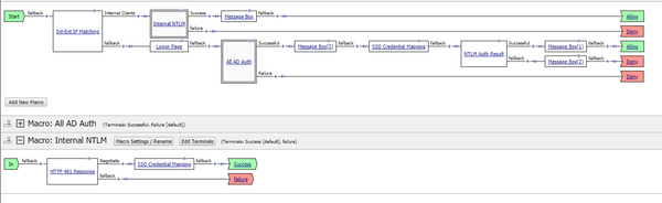

Below is the flow I've made, NTLM auth result I threw in as a test, the message boxes are just debug to see which branch is hit without digging in logs.
The All AD Auth is the AD chain I mentioned, I'm also assigning a variable after each success to set the session.logon.last.domain to the corresponding AD in case it's needed later in the chain.
I'm also doing a basic 401 challenge for internal NTLM and redirecting to either internal or logon page based on client IP.

  • The TMSH config you're missing is the eca profile, it's only needed if your client side NTLM authentication isn't working.
    Is the SSO failing on the forms branch or the NTLM branch?
    IIRC we had issues doing NTLM auth to NTLM SSO and will try and figure out how we got around it.
    Forms to NTLM should be fine, but I'm wondering if the 5 domains/forests is causing the issue. Are you able to test a user that's in the domain that you're doing SSO to?
