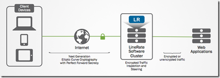

(Editors note: the LineRate product has been discontinued for several years. 09/2023) --- Overview In case you missed it, Why ECC and PFS Matter: SSL offloading with LineRate details some of the reasons why ECC-based SSL has advantages over RSA cryptography for both performance and security. This article will generate all the necessary ECC certificates with the secp384r1 curve so that they may be used to configure an LineRate System for SSL Offload. Getting Started with LineRate In order to appreciate the advantages of SSL/TLS Offload available via LineRate as discussed in this article, let's take a closer look at how to configure SSL/TLS Offloading on a LineRate system. This example will implement Elliptical Curve Cryptography and Perfect Forward Secrecy. SSL Offloading will be added to an existing LineRate System that has one public-facing Virtual IP (10.10.11.11) that proxies web requests to a Real Server on an internal network (10.10.10.1). The following diagram demonstrates this configuration: Figure 1: A high-level implementation of SSL Offload Overall, these steps will be completed in order to enable SSL Offloading on the LineRate System: Generate a private key specifying the secp384r1 elliptic curve Obtain a certificate from a CA Configure an SSL profile and attach it to the Virtual IP Note that this implementation will enable only ECDHE cipher suites. ECDH cipher suites are available, but these do not implement the PFS feature. Further, in production deployments, considerations to implement additional types of SSL cryptography might be needed in order to allow backward compatibility for older clients. Generating a private key for Elliptical Curve Cryptography When considering the ECC curve to use for your environment, you may choose one from the currently available curves list in the LineRate documentation. It is important to be cognizant of the curve support for the browsers or applications your application targets using. Generally, the NIST P-256, P-384, and P-521 curves have the widest support. This example will use the secp384r1 (NIST P-384) curve, which provides an RSA equivalent key of 7680-bits. Supported curves with OpenSSL can be found by running the openssl ecparam -list_curves command, which may be important depending on which curve is chosen for your SSL/TLS deployment. Using OpenSSL, a private key is generated for use with ssloffload.lineratesystems.com. The ECC SECP curve over a 384-bit prime field (secp384r1) is specified: openssl ecparam -genkey -name secp384r1 -out ssloffload.lineratesystems.com.key.pem This command results in the following private key: -----BEGIN EC PARAMETERS----- BgUrgQQAIg== -----END EC PARAMETERS----- -----BEGIN EC PRIVATE KEY----- MIGkAgEBBDD1Kx9hghSGCTujAaqlnU2hs/spEOhfpKY9EO3mYTtDmKqkuJLKtv1P 1/QINzAU7JigBwYFK4EEACKhZANiAASLp1bvf/VJBJn4kgUFundwvBv03Q7c3tlX kh6Jfdo3lpP2Mf/K09bpt+4RlDKQynajq6qAJ1tJ6Wz79EepLB2U40fC/3OBDFQx 5gSjRp8Y6aq8c+H8gs0RKAL+I0c8xDo= -----END EC PRIVATE KEY----- Generating a Certificate Request (CSR) to provide the Certificate Authority (CA) After the primary key is obtained, a certificate request (CSR) can be created. Using OpenSSL again, the following command is issued filling out all relevant information in the successive prompts: openssl req -new -key ssloffload.lineratesystems.com.key.pem -out ssloffload.lineratesystems.com.csr.pem This results in the following CSR: -----BEGIN CERTIFICATE REQUEST----- MIIB3jCCAWQCAQAwga8xCzAJBgNVBAYTAlVTMREwDwYDVQQIEwhDb2xvcmFkbzET MBEGA1UEBxMKTG91aXN2aWxsZTEUMBIGA1UEChMLRjUgTmV0d29ya3MxGTAXBgNV BAsTEExpbmVSYXRlIFN5c3RlbXMxJzAlBgNVBAMTHnNzbG9mZmxvYWQubGluZXJh dGVzeXN0ZW1zLmNvbTEeMBwGCSqGSIb3DQEJARYPYS5yYWdvbmVAZjUuY29tMHYw EAYHKoZIzj0CAQYFK4EEACIDYgAEi6dW73/1SQSZ+JIFBbp3cLwb9N0O3N7ZV5Ie iX3aN5aT9jH/ytPW6bfuEZQykMp2o6uqgCdbSels+/RHqSwdlONHwv9zgQxUMeYE o0afGOmqvHPh/ILNESgC/iNHPMQ6oDUwFwYJKoZIhvcNAQkHMQoTCGNpc2NvMTIz MBoGCSqGSIb3DQEJAjENEwtGNSBOZXR3b3JrczAJBgcqhkjOPQQBA2kAMGYCMQCn h1NHGzigooYsohQBzf5P5KO3Z0/H24Z7w8nFZ/iGTEHa0+tmtGK/gNGFaSH1ULcC MQCcFea3plRPm45l2hjsB/CusdNo0DJUPMubLRZ5mgeThS/N6Eb0AHJSjBJlE1fI a4s= -----END CERTIFICATE REQUEST----- Obtaining a Certificate from a Certificate Authority (CA) Rather than using a self-signed certificate, a test certificate is obtained from Entrust. Upon completing the certificate request and receiving it from Entrust, a simple conversion needs to be done to PEM format. This can be done with the following OpenSSL command: openssl x509 -inform der -in ssloffload.lineratesystems.com.cer -out ssloffload.lineratesystems.com.cer.pem This results in the following certificate: -----BEGIN CERTIFICATE----- MIIC5jCCAm2gAwIBAgIETUKHWzAKBggqhkjOPQQDAzBtMQswCQYDVQQGEwJVUzEW MBQGA1UEChMNRW50cnVzdCwgSW5jLjEfMB0GA1UECxMWRm9yIFRlc3QgUHVycG9z ZXMgT25seTElMCMGA1UEAxMcRW50cnVzdCBFQ0MgRGVtb25zdHJhdGlvbiBDQTAe Fw0xNDA4MTExODQ3MTZaFw0xNDEwMTAxOTE3MTZaMGkxHzAdBgNVBAsTFkZvciBU ZXN0IFB1cnBvc2VzIE9ubHkxHTAbBgNVBAsTFFBlcnNvbmEgTm90IFZlcmlmaWVk MScwJQYDVQQDEx5zc2xvZmZsb2FkLmxpbmVyYXRlc3lzdGVtcy5jb20wdjAQBgcq hkjOPQIBBgUrgQQAIgNiAASLp1bvf/VJBJn4kgUFundwvBv03Q7c3tlXkh6Jfdo3 lpP2Mf/K09bpt+4RlDKQynajq6qAJ1tJ6Wz79EepLB2U40fC/3OBDFQx5gSjRp8Y 6aq8c+H8gs0RKAL+I0c8xDqjgeEwgd4wDgYDVR0PAQH/BAQDAgeAMB0GA1UdJQQW MBQGCCsGAQUFBwMBBggrBgEFBQcDAjA3BgNVHR8EMDAuMCygKqAohiZodHRwOi8v Y3JsLmVudHJ1c3QuY29tL0NSTC9lY2NkZW1vLmNybDApBgNVHREEIjAggh5zc2xv ZmZsb2FkLmxpbmVyYXRlc3lzdGVtcy5jb20wHwYDVR0jBBgwFoAUJAVL4WSCGvgJ zPt4eSH6cOaTMuowHQYDVR0OBBYEFESqK6HoSFIYkItcfekqqozX+z++MAkGA1Ud EwQCMAAwCgYIKoZIzj0EAwMDZwAwZAIwXWvK2++3500EVaPbwvJ39zp2IIQ98f66 /7fgroRGZ2WoKLBzKHRljVd1Gyrl2E3BAjBG9yPQqTNuhPKk8mBSUYEi/CS7Z5xt dXY/e7ivGEwi65z6iFCWuliHI55iLnXq7OU= -----END CERTIFICATE----- Note that the certificate generation process is very familiar with Elliptical Curve Cryptography versus traditional cryptographic algorithms like RSA. Only a few differences are found in the generation of the primary key where an ECC curve is specified. Continue the Configuration Now that the certificates needed to configure Elliptical Curve Cryptography have been created, it is now time to configure SSL Offloading on LineRate. Part 2: Configuring SSL Offload on LineRate continues the demonstration of SSL Offloading by importing the certificate information generated in this article and getting the system up and running. In case you missed it, Why ECC and PFS Matter: SSL offloading with LineRate details some of the reasons why ECC-based SSL has advantages over RSA cryptography for both performance and security. (Editors note: the LineRate product has been discontinued for several years. 09/2023) Stay Tuned! Next week a demonstration on how to verify a correct implementation of SSL with ECC+PFS on LineRate will make a debut on DevCentral. The article will detail how to check for ECC SSL on the wire via WireShark and in the browser. In the meantime, take some time to download LineRate and test out its SSL Offloading capabilities. In case you missed any content, or would like to reference it again, here are the articles related to implementing SSL Offload with ECC and PFS on LineRate: Why ECC and PFS Matter: SSL offloading with LineRate Implementing ECC+PFS on LineRate (Part 1/3): Choosing ECC Curves and Preparing SSL Certificates Implementing ECC+PFS on LineRate (Part 2/3): Configuring SSL Offload on LineRate Implementing ECC+PFS on LineRate (Part 3/3): Confirming the Operation of SSL Offloading555Views0likes0CommentsLightboard Lessons: Perfect Forward Secrecy
