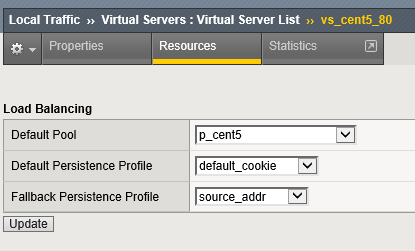

i set up persistence as bellow. i can't see cookie on Persistence Mode item. you can see Source Address Affinity on Persistence Mode item. i find that there is command related with cookie record. root@(ltm_1)(cfg-sync Standalone)(Active)(/Common)(tmos) show ltm persistence persist-records mode cookie all-properties Sys::Persistent Connections Total records returned: 0 Q) what is the reason i can't see cookie record on CLI and GUI. * cookie persistence setting599Views0likes6Comments
