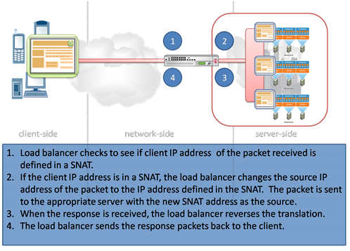

In load balancing scenarios SNAT is used to change the source IP of incoming requests to that of the Load balancer. Now you’re probably thinking this is the reason we end up having to jump through hoops like X-FORWARDED-FOR to get the real client IP address and you’d be right. But the use of SNAT for this purpose isn’t intentionally malevolent. Really. In most cases it’s used to force the return path for responses through the load balancer, which is important when network routing from the server (virtual or physical) to the client would bypass the load balancer. This is often true because servers need a way to access the Internet for various reasons including automated updates and when the application hosted on the server needs to call out to a third-party application, such as integrating with a Web 2.0 site via an API call. In these situations it is desirable for the server to bypass the load balancer because the traffic is initiated by the server, and is not usually being managed by the load balancer.
In the case of a request coming from a client the response needs to return through the load balancer because incoming requests are usually destination NAT’d in most load balancing configurations, so the traffic has to traverse the same path, in reverse, in order to undo that translation and ensure the response is delivered to the client.
Most land balancing solutions offer the ability to specify, on a per-IP address basis, the SNAT mappings as well as providing an “auto map” feature which uses the IP addresses assigned to load balancer (often called “self-ip” addresses) to perform the SNAT mappings. Advanced load balancers have additional methods of assigning SNAT mappings including assigning a “pool” of addresses to a virtual (network) server to be used automatically as well as intelligent SNAT capabilities that allow the use of network-side scripting to manipulate on a case-by-case basis the SNAT mappings. Most configurations can comfortably use the auto map feature to manage SNAT, by far the least complex of the available configurations.

@Daniel,
No, in step 4 the packets returned to the client should be that of the VIP.
Lori
