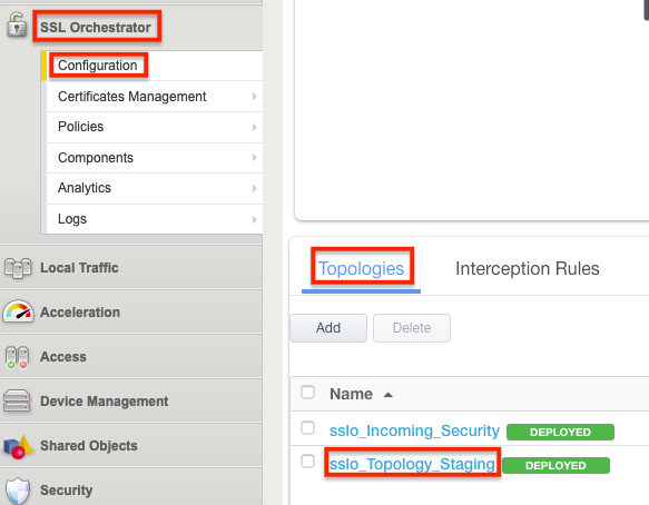

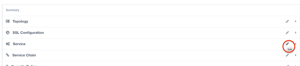

From the SSL Orchestrator Configuration Utility click SSL Orchestrator > Configuration > Topologies > sslo_Topology_Staging.
Click the pencil icon on the right to edit the Service.

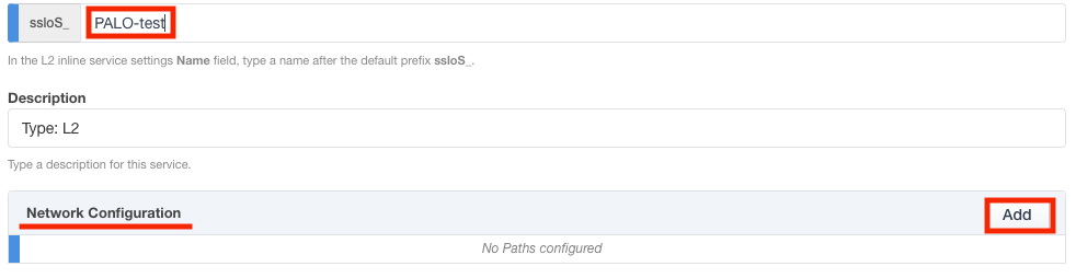

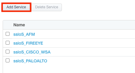

Click Add Service.
Select the Palo Alto Service and click Add.
Give it a name or leave the default.  Click Add under Network Configuration.

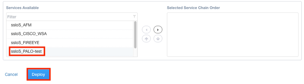

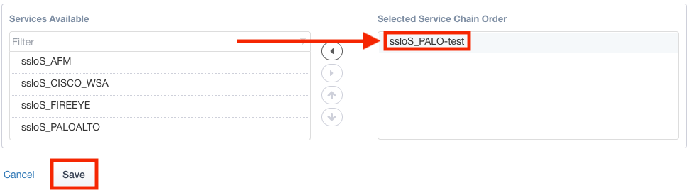

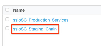

Click the Service Chain icon.
Click the Staging_Chain.

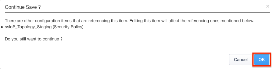

Move the PALO-test Service from Available to Selected and click Save.
Click OK.
Click Deploy.
Click OK.

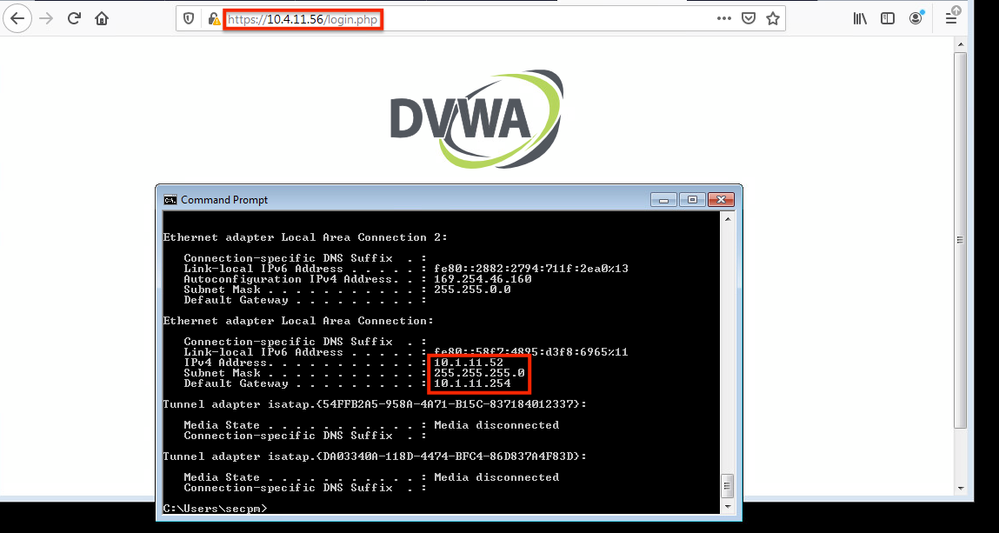

We created a policy with source IP = 10.1.11.52 to use the new PaloAlto Service that we just performed maintenance on.
Go to that client computer and verify that everything is still working as expected.
As you can see this is the test client with IP 10.1.11.52. The page still loads for one of the web servers.
You can view the Certificate and see that it is not the same as the Production Certificate.

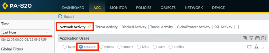

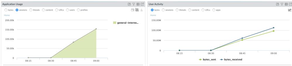

To ensure that everything is working as expected you can view the ACC statistics on Palo_Alto1, which was the Palo Alto device removed from the Production network.
From ACC select Network Activity then Sessions.  A time filter can be set on the left.
You should see something like the image below, where Sessions and Bytes sent/received are gradually increasing.

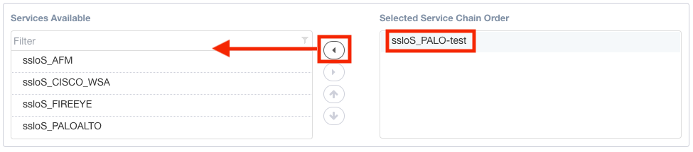

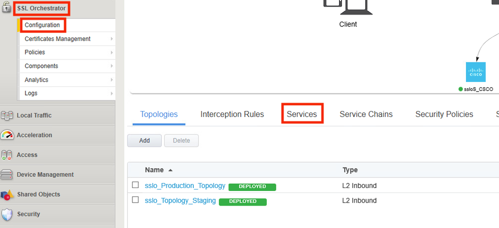

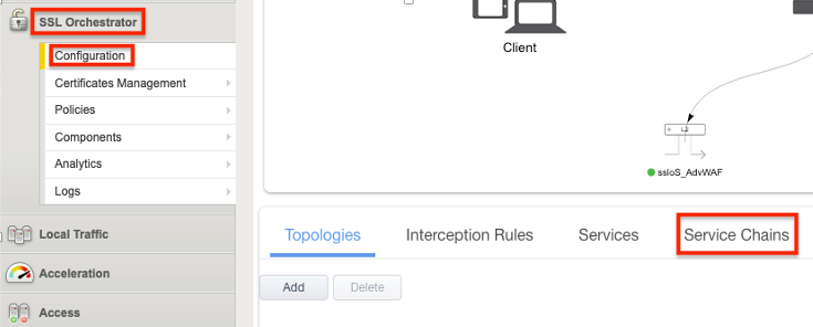

From the SSL Orchestrator GUI select SSL Orchestrator > Configuration > Service Chains.
Select the Staging_Chain.
Select ssloS_PALO-test on the right and click the left arrow to remove it from Selected.
Click Deploy when done.
Click OK.
Click OK to the Success message.

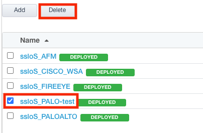

From the SSL Orchestrator Guided Configuration select SSL Orchestrator > Configuration > Services.
Select the PALO-test Service and click Delete.
Click OK to the Warning.

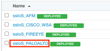

When that is done click the ssloS_PALOALTO Service.
Click the Pencil icon to edit the Service.

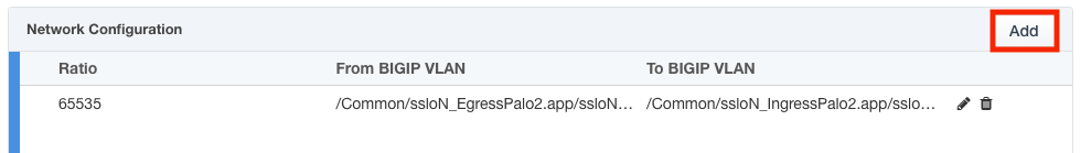

Under Network Configuration click Add.

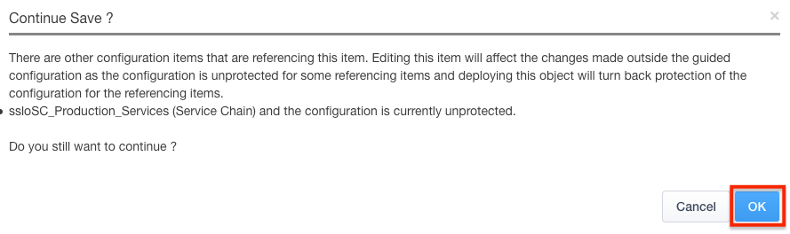

Set the Ratio to the same value as PaloAlto2, 65535 in this example.  Set the From and To VLAN the following and click Done.
Click Save & Next at the bottom.
Click OK.

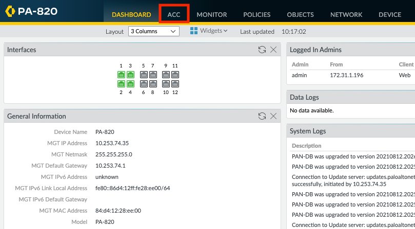

To ensure that everything is working as expected you can view the statistics on Palo_Alto1.
From the Palo Alto GUI select ACC (Application Command Center).
Select Network Activity then Sessions.  A time filter can be set on the left.
Palo_Alto1 appears to be completely healthy.
