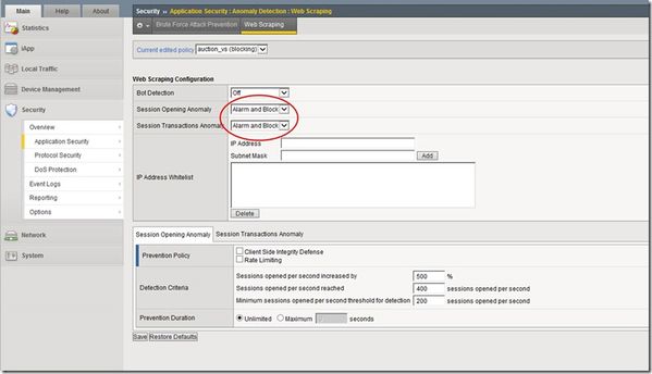

In case you missed it in the bot detection article, here's a quick screenshot that shows the location and settings of the Session Opening and Session Transactions Anomaly in the ASM.  You'll find all the fun when you navigate to Security > Application Security > Anomaly Detection > Web Scraping.  There are three different settings in the ASM for Session Anomaly: Off, Alarm, and Alarm and Block.  (Note: these settings are configured independently...they don't have to be set at the same value)
Obviously, if Session Anomaly is set to "Off" then the ASM does not check for anomalies at all.  The "Alarm" setting will detect anomalies and record attack data, but it will allow the client to continue accessing the website.  The "Alarm and Block" setting will detect anomalies, record the attack data, and block the suspicious requests.

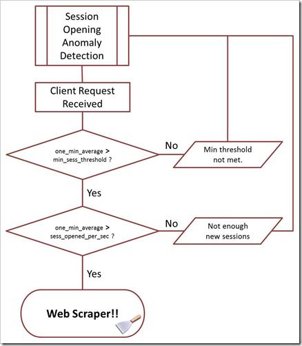

First Method: Predefined Ceiling Value
This method uses the user-defined "minimum sessions opened per second threshold for detection" value and compares it to the one-minute running average.  If the one-minute average is less than this number, then nothing else happens because the minimum threshold has not been met.  But, if the one-minute average is higher than this number, the ASM goes on to compare the one-minute average to the user-defined "sessions opened per second reached" value.  If the one-minute average is less than this value, nothing happens.  But, if the one-minute average is higher than this value, the ASM will declare the client a web scraper.  The following flowchart provides a pictorial representation of this process.

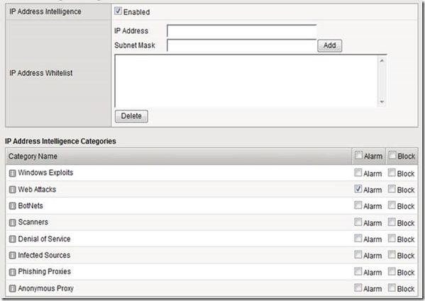

  • Drop IP Addresses with bad reputation: The system drops requests from IP addresses that have a bad reputation according to the system’s IP Address Intelligence database (shown above).  The ASM will drop all request from any "bad" IP addresses even if they respond with a TS cookie.  IP addresses that do not have a bad reputation also undergo rate limiting.  The default for this option is disabled.  Keep in mind that this option is available only after Rate Limiting is enabled.  In addition, this option is only enforced if at least one of the IP Address Intelligence Categories is set to Alarm mode.

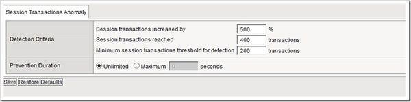

How does the ASM detect all this bad behavior?  Well, since it's trying to find clients that surf your site much more than other clients, it tracks the number of transactions per client session (note: the ASM will drop a session from the table if no transactions are performed for 15 minutes).  It also tracks the average number of transactions for all current sessions (note: the ASM calculates the average transaction value every minute).  It can use these two figures to compare a specific client session to a reasonable baseline and figure out if the client is performing too many transactions.  The ASM can automatically figure out the number of transactions per client, but it needs some user-defined thresholds to conduct the appropriate comparisons.  These thresholds are as follows:
Session transactions increased by: This specifies that the system considers traffic to be an attack if the number of transactions per session increased by the percentage listed. The default setting is 500 percent.
Session transactions reached: This specifies that the system considers traffic to be an attack if the number of transactions per session is equal to or greater than this number. The default value is 400 transactions.
Minimum session transactions threshold for detection: This specifies that the system considers traffic to be an attack if the number of transactions per session is equal to or greater than this number, and at least one of the "Sessions transactions increased by" or "Session transactions reached" numbers was reached.  If the number of transactions per session is lower than this number, the system does not consider this traffic to be an attack even if one of the "Session transactions increased by" or "Session transaction reached" numbers was reached. The default value is 200 transactions.

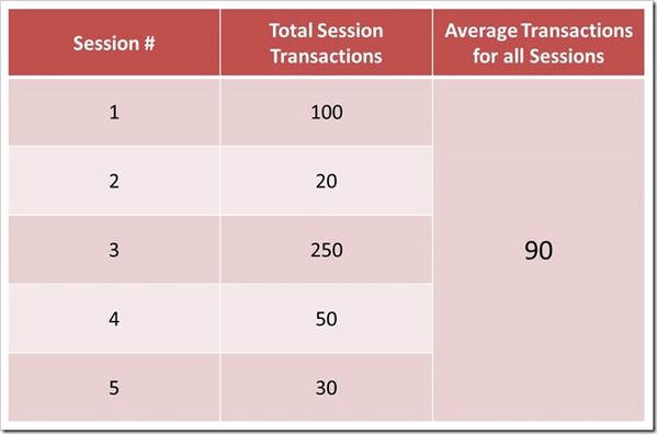

The following table shows an example of how the ASM calculates transaction values (averages and individual sessions).
We would expect that a given client session would perform about the same number of transactions as the overall average number of transactions per session.  But, if one of the sessions is performing a significantly higher number of transactions than the average, then we start to get suspicious.  You can see that session 1 and session 3 have transaction values higher than the average, but that only tells part of the story.  We need to consider a few more things before we decide if this client is a web scraper or not.  By the way, if the ASM knows that a given session is malicious, it does not use that session's transaction numbers when it calculates the average.
Now, let's roll in the threshold values that we discussed above.  If the ASM is going to declare a client as a web scraper using the session transaction anomaly defense, the session transactions must first reach the minimum threshold.  Using our default minimum threshold value of 200, the only session that exceeded the minimum threshold is session 3 (250 > 200).  All other sessions look good so far...keep in mind that these numbers will change as the client performs additional transactions during the session, so more sessions may be considered as their transaction numbers increase.
Since we have our eye on session 3 at this point, it's time to look at our two methods of detecting an attack.
The first detection method is a simple comparison of the total session transaction value to our user-defined "session transactions reached" threshold.  If the total session transactions is larger than the threshold, the ASM will declare the client a web scraper.
Our example would look like this:
Is session 3 transaction value >  threshold value (250 > 400)?  No, so the ASM does not declare this client as a web scraper.
The second detection method uses the "transactions increased by" value along with the average transaction value for all sessions.  The ASM multiplies the average transaction value with the "transactions increased by" percentage to calculate the value needed for comparison.
90 * 500% = 450 transactions
Is session 3 transaction value > result (250 > 450)?  No, so the ASM does not declare this client as a web scraper.
By the way, only one of these detection methods needs to be met for the ASM to declare the client as a web scraper.  You should be able to see how the user-defined thresholds are used in these calculations and comparisons.  So, it's important to raise or lower these values as you need for your environment.
