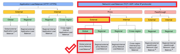

Which load balancer type fits best?
This guide outlines our options for Google LB’s. Because our requirements include global, TCP-only load balancing, we will choose the highlighted LB type of “Global external proxy Network Load Balancer”.
Requirements of global load balancer, and TCP-only, determined this load balancer type.

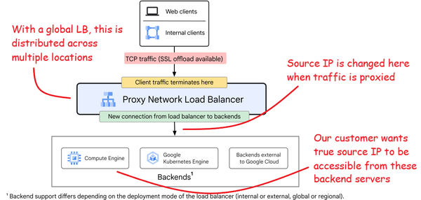

Proxy vs Passthrough
Notice that global LB’s proxy traffic. They do not preserve source IP address as a passthrough LB does. Global IP addresses are advertised from multiple, globally-distributed front end locations, using Anycast IP routing.
Proxying from these locations allows traffic symmetry, but Source NAT causes loss of the original client IP address. I've added some comments into a Google diagram below to show our core problem here:

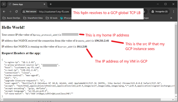

Displaying true source IP in our web app
You might notice above that NGINX is proxying to http://localhost:3000. I have a simple NodeJS app to display a page with HTTP headers:
const express = require('express');
const app = express();
const port = 3000;
// set the view engine to ejs
app.set('view engine', 'ejs');
app.get('/', (req, res) => {
        const proxy_protocol_addr = req.headers['x-proxy-protocol-source-ip'];
        const source_ip_addr = req.headers['x-real-ip'];
        const array_headers = JSON.stringify(req.headers, null, 2);
        const nginx_ip_addr = req.headers['x-nginx-ip'];
    res.render('index', {
        proxy_protocol_addr: proxy_protocol_addr,
        source_ip_addr: source_ip_addr,
        array_headers: array_headers,
        nginx_ip_addr: nginx_ip_addr
app.listen(port, () => {
  console.log('Server is listenting on port 3000');
For completeness, NodeJS is using the EJS template engine to build our page. The file views/index.ejs is here:
<!DOCTYPE html>
<html lang="en">
<head>
        <meta charset="UTF-8">
        <meta name="viewport" content="width=device-width, initial-scale-1">
        <title>Demo App</title>
</head>
<body class="container">
<main>
        <h2>Hello World!</h2>
        <p>True source IP (the value of <code>$proxy_protocol_addr</code>) is <b><%= typeof proxy_protocol_addr != 'undefined' ? proxy_protocol_addr : '' %></b></p>
        <p>IP address that NGINX recieved the connection from (the value of <code>$remote_addr</code>) is <b><%= typeof source_ip_addr != 'undefined' ? source_ip_addr : '' %> </b></p>
        <p>IP address that NGINX is running on (the value of <code>$server_addr</code>) is <b><%= typeof nginx_ip_addr != 'undefined' ? nginx_ip_addr : '' %></b><p>
        <h3>Request Headers at the app:</h3>
        <pre><%= typeof array_headers != 'undefined' ? array_headers : '' %></pre>
</main>
</body>
</html>

Our end result
This small demo app shows that true source IP can be known to an application running on Google VM’s when using the Global TCP Network Load Balancer. We’ve achieved this using PROXY protocol and NGINX. We’ve used NodeJS to display a web page with proxied header values.
Simple demo app showing source IP obtained from parsing PROXY protocol
