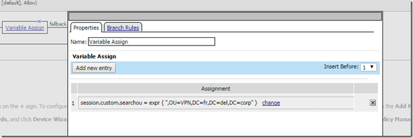

The next object is a Variable Assign where we will set a custom variable (session.custom.searchou) to make it where you don’t need to modify the javascript code. This string will be removed from the full DN to make the dropdown list easier to read so it needs to start with a comma as the full DN for a group is “CN=VEND1-QA,OU=VPN,DC=fr,DC=del,DC=corp”.

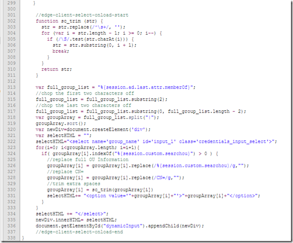

The only other piece to this is a customized logon.inc page which will be applied to the second logon page. I will provide the full logon.inc page you can use to replace the current one as an attachment below. The screenshot is here to show you the custom code. This is just basic JavaScript to take the list of groups you are a member of and clean it up, split it into an array, then check to see which groups are in the VPN OU. If the groups is in the VPN OU then we will do a little bit more formatting on the string before we eventually append it to the “dynamicInput” element we will also create on the logon.inc page.

7. Add a Variable Assign Action along the Edge Client Branch: In this variable assign enter the following into the assignment.
Custom Variable = session.custom.searchou
Custom Expression = expr { ",OU=VPN,DC=fr,DC=del,DC=corp" }

11. Now that we have the Access Policy Create and the VPE configured the next step is to go into advanced customization and replace the logon.inc for the second logon page labeled “VPN Decision – LP”.
To modify the page we need to go to Access Policy > Customization > Advanced.
12. Expand the folder tree to get to the logon.inc page. Customization Settings > Access Profiles > /Common/edge_client_select > Access Policy > Logon Pages > VPN Decision – LP > logon.inc
13. Click on the logon.inc and on the right side of the screen select all text and replace with the code at the following link.
https://dl.dropboxusercontent.com/u/27996759/f5/na-edge/logon.inc.txt
