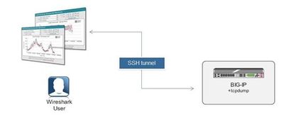

We actually can do that without installing X, wireshark and hundreds of libraries on BIG-IP. Which is not an option anyway. 🙂
There are a few things we need:
- SSH access to the BIG-IP, bash or tmsh is fine
- Proper SSH client on our Desktop, eg. OpenSSH or alternatives (putty & plink)
The trick is to launch an ssh session without a login shell and run tcpdump through it on the remote system making tcpdump write raw packets to STDOUT while piping it to our local wireshark reading from STDIN.
