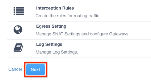

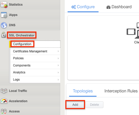

From the BIG-IP Configuration Utility select SSL Orchestrator > Configuration. Click Add under Topologies.

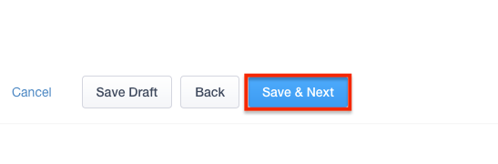

Scroll to the bottom of the next screen and click Next.

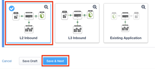

Give it a name, Topology_Staging in this example.
Select L2 Inbound as the Topology type then click Save & Next.

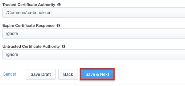

For the SSL Configurations you can leave the default settings. Click Save & Next at the bottom.
Click Save & Next at the bottom of the Services List.

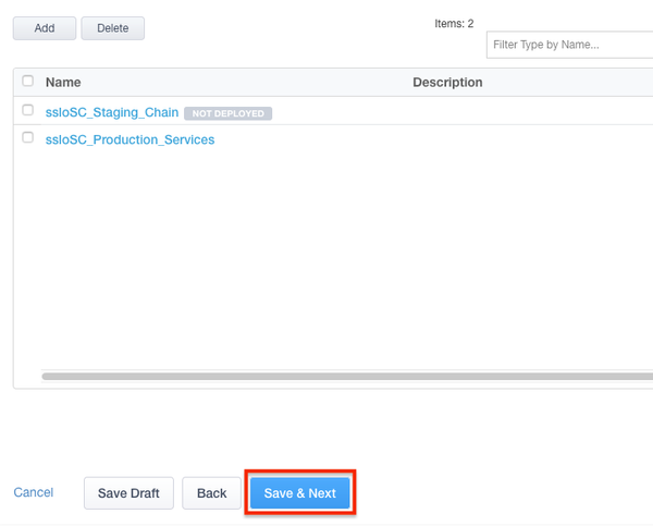

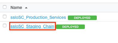

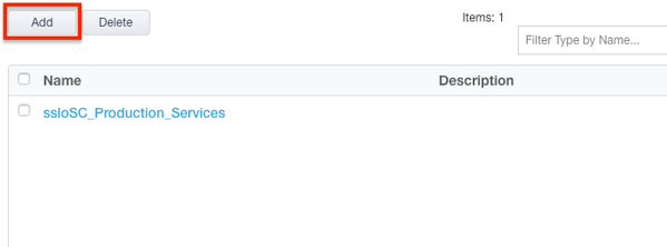

Click the Add button under Services Chain List. A new Service Chain is needed so we can remove Palo_Alto1 from the Production Service and add it here.

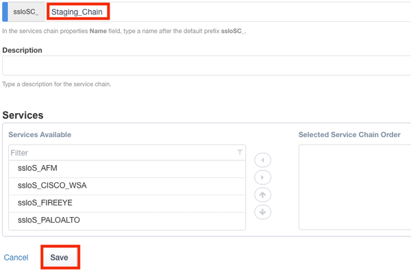

Give the Service Chain a name, Staging_Chain in this example. Click Save at the bottom.
Note: The Service will be added to this Service Chain later.
Click Save & Next.

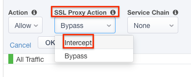

Click the Add button on the right to add a new rule.

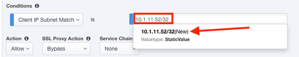

For Conditions select Client IP Subnet Match.
Enter the Client IP and mask, 10.1.11.52/32 in this example. Click New to add the IP/Subnet.

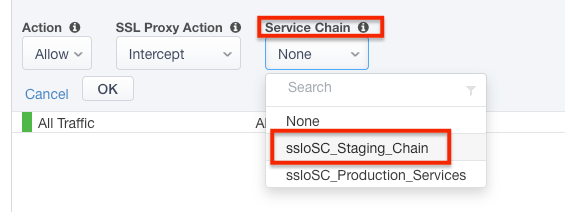

Set the SSL Proxy Action to Intercept.
Set the Service Chain to the one created previously.
Click OK.
Note: This rule is written so that a single client computer (10.1.11.52) will match and can be used for testing.

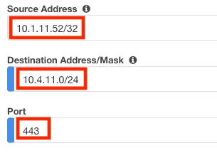

For the Interception Rule set the Source Address to 10.1.11.52/32. Set the Destination Address/Mask to 10.4.11.0/24. Set the port to 443.

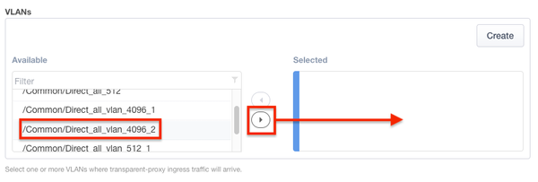

Select the VLAN for your Ingress Network and move it to Selected.

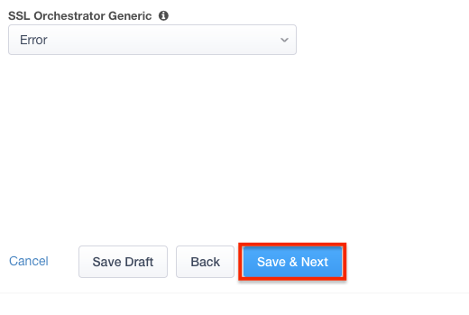

For Log Settings, scroll to the bottom and select Save & Next.

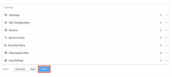

Click Deploy.

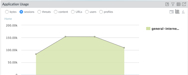

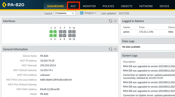

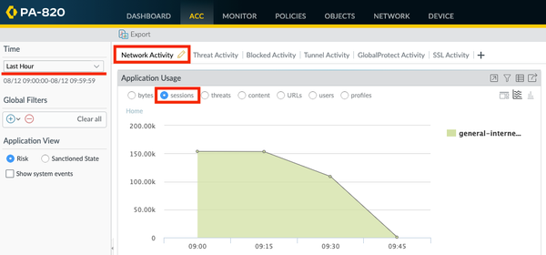

Check the statistics on the Palo Alto NGFW we will be performing maintenance on. It’s “Palo_Alto1” in this example.
From the Palo Alto GUI select ACC (Application Command Center).

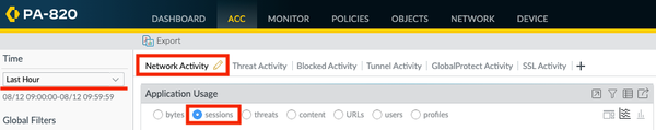

Select Network Activity then Sessions. A time filter can be set on the left, in this case it’s set to the Last Hour.
Palo_Alto1 appears to be completely healthy.

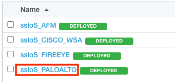

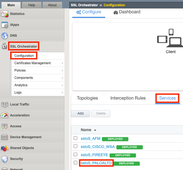

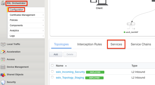

Back to the SSL Orchestrator Configuration Utility. Click SSL Orchestrator > Configuration > Services > then the Service name, ssloS_PALOALTO in this example.
Click the pencil icon to edit the Service.

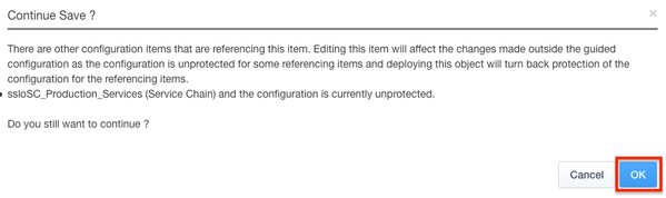

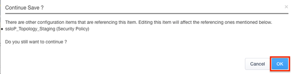

Click OK if presented with the following warning.

Check Palo Alto Statistics Again
Check the ACC statistics on “Palo_Alto1”. It should look like the image below, with the number of sessions tapering off until there is zero.

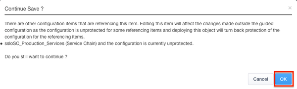

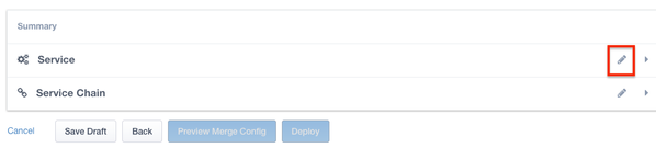

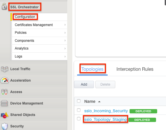

From the SSL Orchestrator Configuration Utility click SSL Orchestrator > Configuration > Topologies > sslo_Topology_Staging.
Click the pencil icon on the right to edit the Service.

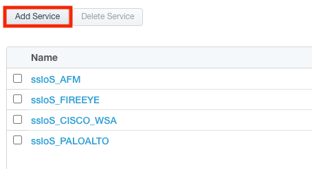

Click Add Service.
Select the Palo Alto Networks NGFW Inline Layer 2 Service and click Add.
Give it a name or leave the default. Click Add under Network Configuration.

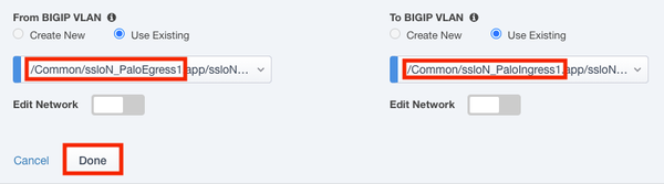

Set the FROM and TO VLANS to the following and click Done.

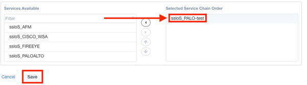

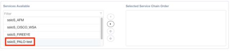

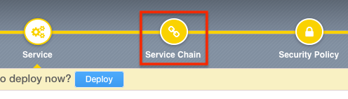

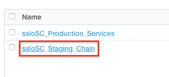

Click the Service Chain icon.
Click the Staging_Chain.
Move the PALO-test Service from Available to Selected and click Save.
Click OK.

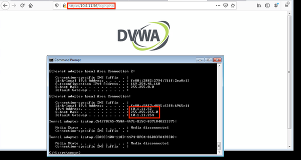

Test functionality with a single client
We created a policy with source IP = 10.1.11.52 to use the new Palo Alto Service that we just performed maintenance on.
Go to that client computer and verify that everything is still working as expected.

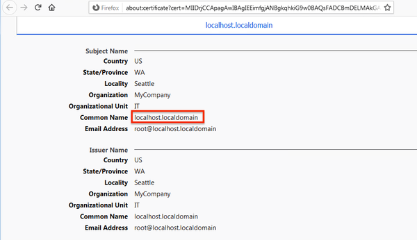

As you can see this is the test client with IP 10.1.11.52. The page still loads for one of the web servers.
You can view the Certificate and see that it is not the same as the Production Certificate.

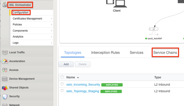

From the SSL Orchestrator GUI select SSL Orchestrator > Configuration > Service Chains.

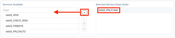

Select the Staging_Chain.
Select ssloS_PALO-test on the right and click the left arrow to remove it from Selected.
Click Deploy when done.

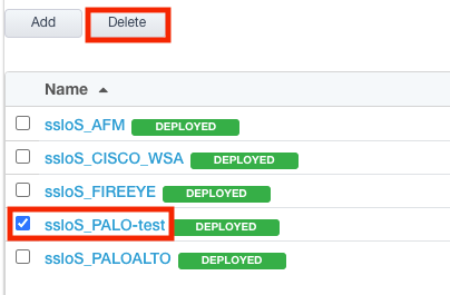

From the SSL Orchestrator Guided Configuration select SSL Orchestrator > Configuration > Services.
Select the PALO-test Service and click Delete.
Click OK to the Warning.
When that is done click the ssloS_PALOALTO Service.
Click the Pencil icon to edit the Service.

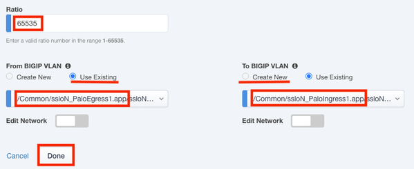

Set the Ratio to the same value as PaloAlto2, 65535 in this example. Set the From and To VLAN the following and click Done.
