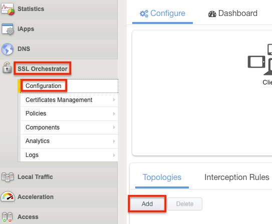

From the BIG-IP Configuration Utility select SSL Orchestrator > Configuration. Click Add under Topologies.

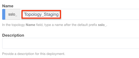

Give it a name, Topology_Staging in this example.

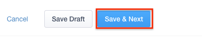

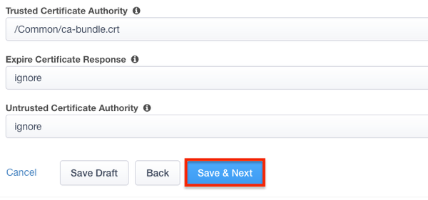

For the SSL Configurations you can leave the default settings. Click Save & Next at the bottom.
Click Save & Next at the bottom of the Services List.

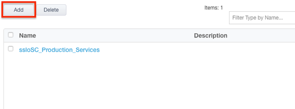

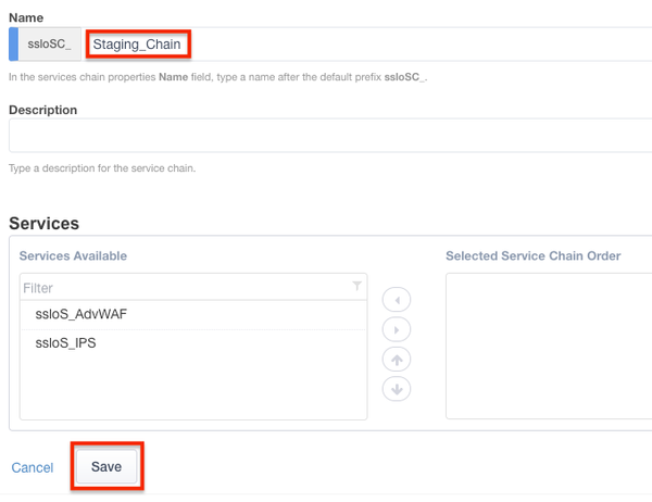

Click the Add button under Services Chain List. A new Service Chain is needed so we can remove Fireeye1 from the Production Service and add it here.
Give the Service Chain a name, Staging_Chain in this example. Click Save at the bottom.
Note: The Service will be added to this Service Chain later.

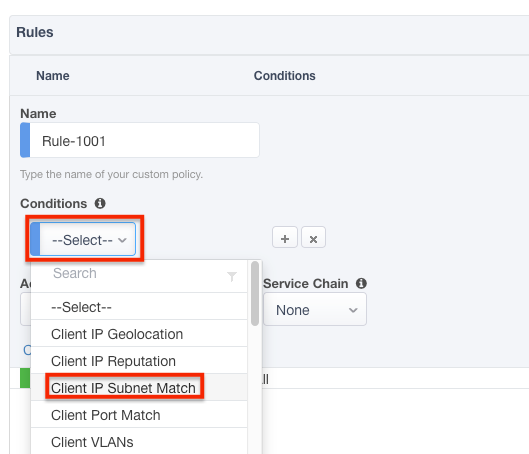

Click the Add button on the right to add a new rule.

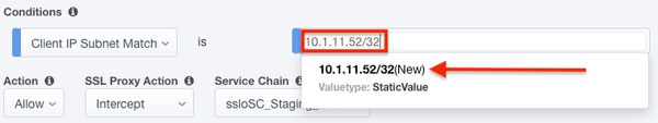

For Conditions select Client IP Subnet Match.
Enter the Client IP and mask, 10.1.11.52/32 in this example. Click New to add the IP/Subnet.
Set the SSL Proxy Action to Intercept.

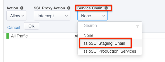

Set the Service Chain to the one created previously.
Click OK.
Note: This rule is written so that a single client computer (10.1.11.52) will match and can be used for testing.

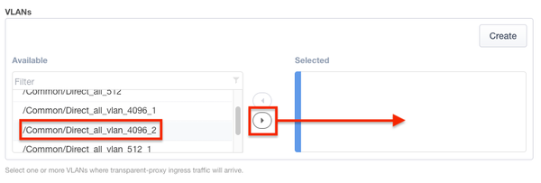

For the Interception Rule set the Source Address to 10.1.11.52/32. Set the Destination Address/Mask to 10.4.11.0/24. Set the port to 443.
Select the VLAN for your Ingress Network and move it to Selected.
Set the L7 Profile to Common/http.

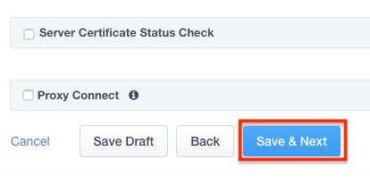

For Log Settings, scroll to the bottom and select Save & Next.

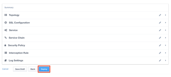

Click Deploy.

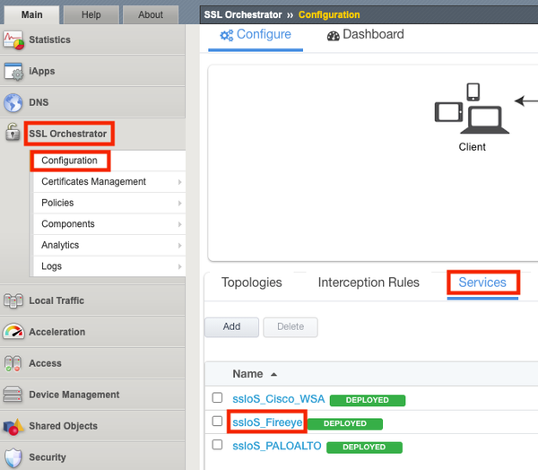

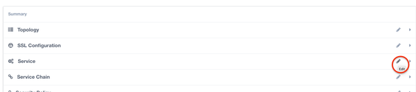

Back to the SSL Orchestrator Configuration Utility. Click SSL Orchestrator > Configuration > Services > then the Service name, ssloS_Fireeye in this example.
Click the pencil icon to edit the Service.

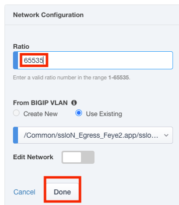

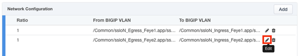

Click the pencil icon to edit the Network Configuration for Fireeye2.
Set the ratio to 65535 and click Done.

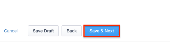

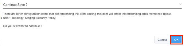

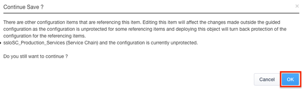

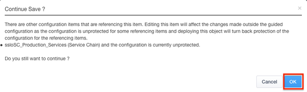

Click OK if presented with the following warning.

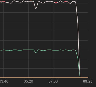

Check FireEye Statistics Again
From the FireEye Dashboard scroll down to the Monitored Traffic widget. It should look like the image below, with the number of sessions tapering off until there is zero.

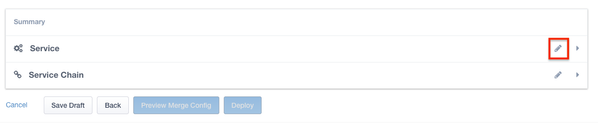

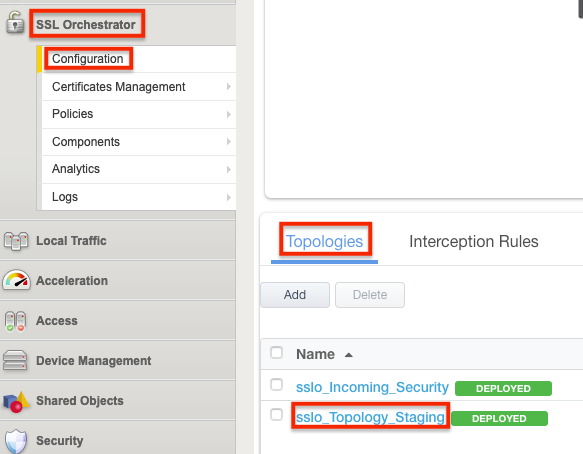

From the SSL Orchestrator Configuration Utility click SSL Orchestrator > Configuration > Topologies > sslo_Topology_Staging.
Click the pencil icon on the right to edit the Service.

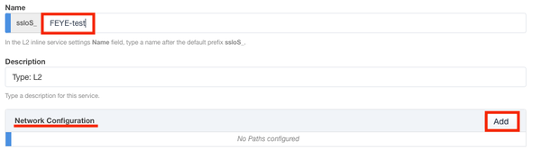

Give it a name or leave the default. Click Add under Network Configuration.

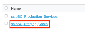

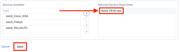

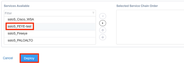

Click the Service Chain icon.
Click the Staging_Chain.
Move the FEYE-test Service from Available to Selected and click Save.
Click OK.
Click Deploy.

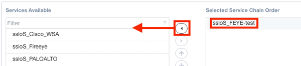

Select ssloS_FEYE-test on the right and click the left arrow to remove it from Selected

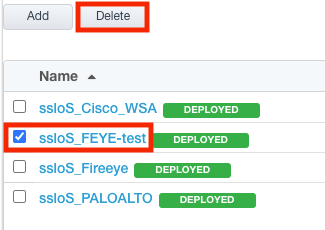

From the SSL Orchestrator Guided Configuration select SSL Orchestrator > Configuration > Services.
Select the FEYE-test Service and click Delete.
Click OK to the Warning.

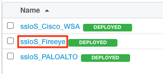

When that is done click the ssloS_Fireeye Service.
Click the Pencil icon to edit the Service.

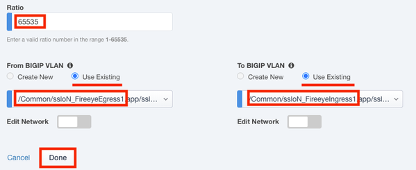

Under Network Configuration click Add.
Set the Ratio to the same value as Fireeye2, 65535 in this example. Set the From and To VLAN the following and click Done.

Click OK.
