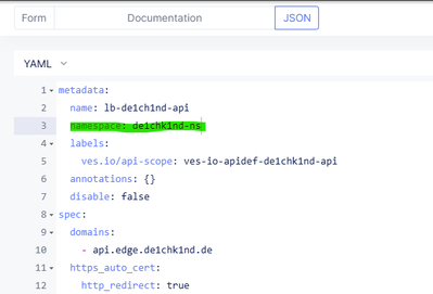

Simple enough, right? Just change the namespace field and save...
Except you can't. There is no "move" operation on F5 XC - not in the UI, not in the API. Changing the namespace of a load balancer means deleting it in the source and re-creating it in the target. And that is where things get complicated.
