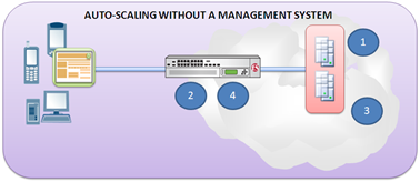

This process is relatively straightforward and can even be accomplished without the “external entity” by directly integrating the application with the load balancing service. By hooking the appropriate setup and tear-down routines in the application, the load balancer can be automatically instructed to perform the appropriate actions whenever an instance of that application is launched or terminated.
1. Application is initialized and instructs load balancer to add it to the appropriate resource pool.
2. Load balancer adds the application instance to the right pool of resources and begins directing traffic to it as configured.
3. Application is terminating, instructs load balancer to remove it from the available resource pool.
4. Load balancer removes the application instance from pool of resources.
This requires tighter coupling of the load balancer with the application, however, which may be less than ideal unless you are very tied to your load balancing solution. The advantage of this solution is that regardless of whether the application is “physical” or “virtual”, the same process occurs, which lets you mix and match and be a lot more flexible in your architecture.
