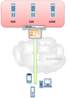

Let’s say you’ve got a pool of application instances and you know the capacity of each in terms of connections (X). Two of the servers can handle 500 concurrent connections, and one can handle 1000 concurrent connections.
Now assume that your load balancer is configured to perform standard round robin load balancing between the three instances. Even though the total capacity of these three servers appears to be 2000 concurrent connections, by the time you hit 1501, the first of the three servers will be over capacity because it will have to try to handle 501 connections. If you tweak the configuration just a bit to indicate the maximum connection capacity for each node (instance) you can probably avoid this situation, but there are no guarantees.
Now let’s make a small change in the algorithm – instead of standard round robin we’ll use weighted round robin (often called “ratio”), and give the largest capacity server a higher weight based on its capacity ratio to the other servers, say 2. This means the “bigger” server will receive twice as many requests as the other two servers, which brings the total capacity closer to what is expected.
You might be thinking that a least connection algorithm would be more appropriate in a heterogeneous environment, but that’s not the case. Least connection algorithms base distribution upon the number of connections currently open on any given server instance; it does not necessarily take into consideration the maximum connection capacity for that particular node. Fastest response time combined with per node connection limits would be a better option, but a fastest response time algorithm tends to result in a very unequal distribution as load increases in a heterogeneous environment.
This does not, however, say anything about the performance of the application when using any of the aforementioned algorithms. We do know that as application instances near capacity performance tends to degrade. Thus we could extrapolate that the performance for the two “smaller” servers will degrade faster than the performance for the bigger server because they will certainly reach capacity under high load before the larger server instance – when using some algorithms, at least. Algorithms like fastest response time and least connections tend to favor higher performing servers which means in the face of a sudden spike of traffic performance may degrade using that algorithm as well.

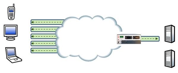

What is TCP multiplexing?
TCP multiplexing is a technique used primarily by load balancers and application delivery controllers (but also by some stand-alone web application acceleration solutions) that enables the device to "reuse" existing TCP connections. This is similar to the way in which persistent HTTP 1.1 connections work in that a single HTTP connection can be used to retrieve multiple objects, thus reducing the impact of TCP overhead on application performance.
TCP multiplexing allows the same thing to happen for TCP-based applications (usually HTTP / web) except that instead of the reuse being limited to only 1 client, the connections can be reused over many clients, resulting in much greater efficiency of web servers and faster performing applications.
