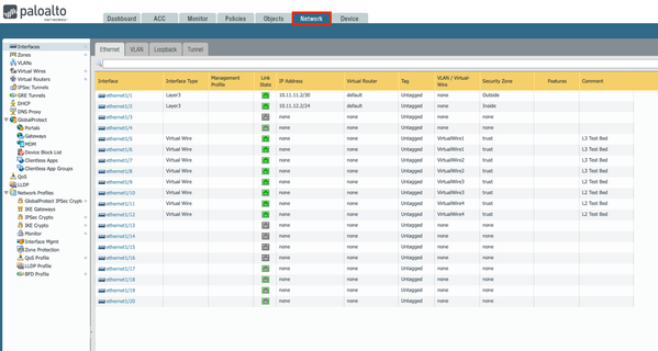

From the Palo Alto UI go to the Network tab > Interfaces.

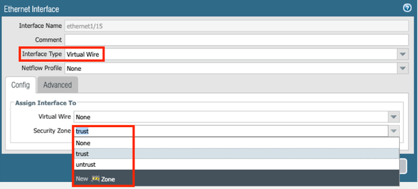

Click the name (ethernet1/X) of the interface you wish to configure.
Set the Interface Type to Virtual Wire and the Security Zone to trust. Click OK.

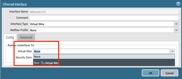

Click the name of one of the interfaces configured previously. Click Virtual Wire > New Virtual Wire.
Give it a name. Select the 2 interfaces configured previously. Click OK and OK.
You will need to Commit the changes for them to take effect.
Note: setting the Security Zone to trust is needed for the F5 Health Monitors to work.
