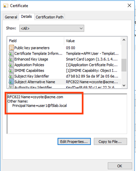

The F5 Access Policy Manager uses the Universal Principal Name (UPN) taken from the Subject Alternative Name (SAN) field of the Signature Certificate to search for the user in LDAP and allow or deny access based on the information found.
The diagram below shows the value that we will be pulling from the certificate to use for further authentication. On a DoD CAC the UPN would be of the format EDIPI@mil.

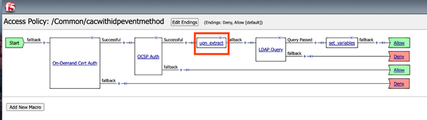

In the diagram below we are placing a variable assign access policy item after checking that the certificate is valid through mutual tls with the On Demand Cert Auth and then checking with an OCSP server that the certificate has not been revoked via OCSP.

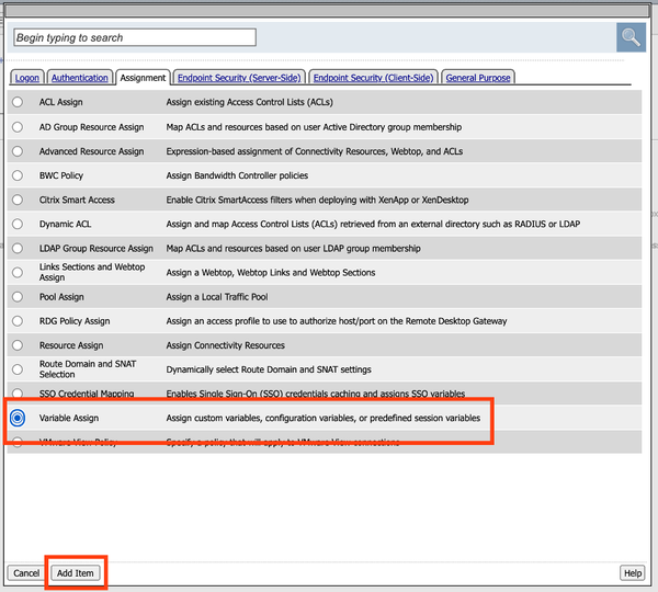

To add the variable assign click the ‘+’ item in the visual policy editor and select the variable assign item in the visual policy editor.
The variable assign is under the Assignment tab in the Visual Policy Editor.

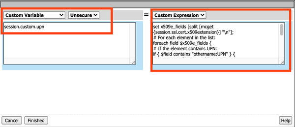

In the variable assign give the access policy item a name for instance “upn_extract” and then click the “Add New Entry” button.
Then ensure that Custom Variable is selected
Create a variable name – for instance session.custom.upn
On the right side select “Custom Expression”
And place the following expression in the entry field below.. this expression parses the x509 certificate attributes on the CAC card for the UPN.
set x509e_fields [split [mcget {session.ssl.cert.x509extension}] "\n"];
# For each element in the list:
foreach field $x509e_fields {
# If the element contains UPN:
if { $field contains "othername:UPN" } {
## set start of UPN variable
set start [expr {[string first "othername:UPN<" $field] +14}]
# UPN format is <user@domain>
# Return the UPN, by finding the index of opening and closing brackets, then use string range to get everything between.
return [string range $field $start [expr { [string first ">" $field $start] - 1 } ] ]; } }
# Otherwise return UPN Not Found:
return "UPN-NOT-FOUND";
Click “Finished”.

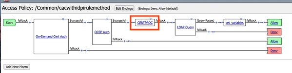

In the diagram below we are placing an iRule event access policy item after checking that the certificate is valid through mutual tls with the On Demand Cert Auth and then checking with an OCSP server that the certificate has not been revoked via OCSP.

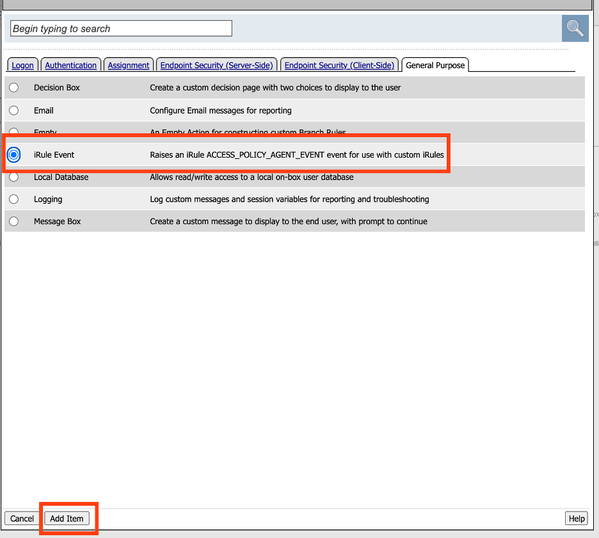

To add the iRule Event click the ‘+’ item in the visual policy editor and select the variable assign item in the visual policy editor.
The iRule Event is under the General Purpose tab in the Visual Policy Editor.

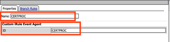

Then provide a name and a Custom iRule Event Agent ID. I like to make the name the same as the identifier, but they can bet different.
The custom iRule Event Agent ID ties the visual policy editor iRule event item to an iRule.

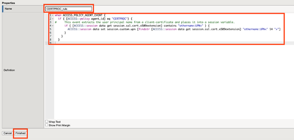

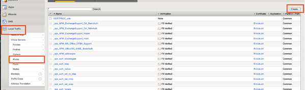

Create the iRule.
Now under Local Traffic/iRules click the create button.
Provide a name for the iRule.
And place the following iRule in the entry field this iRule parses the x509 certificate attributes on the CAC card for the UPN.
when ACCESS_POLICY_AGENT_EVENT {
if { [ACCESS::policy agent_id] eq "CERTPROC"} {
# This event extracts the user principal name from a client-certificate and places it into a session variable.
if { [ACCESS::session data get session.ssl.cert.x509extension] contains "othername:UPN<" } {
ACCESS::session data set session.custom.upn [findstr [ACCESS::session data get session.ssl.cert.x509extension] "othername:UPN<" 14 ">"]
Click “Finished”

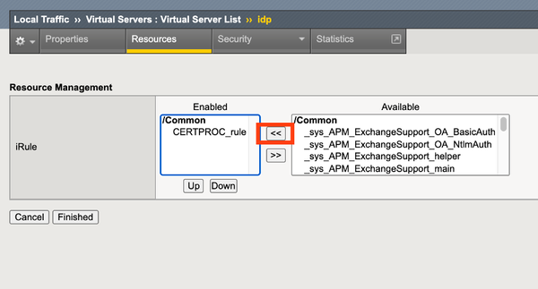

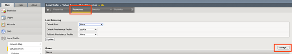

Then on the virtual server that provides the service select “Resources” and then select “Manage”
Finally move the CERTPROC iRule from available to enabled.
