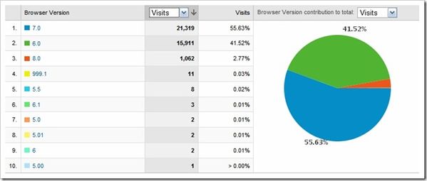

In Scott's post, he showed off some of the stats for his blog revealing that close to 20% of the viewers of his site were using IE6.  Of course, I decided to see how his numbers matched up against IE users on DevCentral.  I pulled up a relevant sample of stats and found that a whopping 41% of DevCentral users are running IE6.
In retrospect, this sort of makes sense as DevCentral has a large population of corporate users who have less control on the software that runs on their laptops/PCs/etc.  So, for those, upgrading may not be possible.  But, I'm sure that a good portion of those IE6 users out there, just haven't taken the steps to upgrade to a more secure browsing platform.
