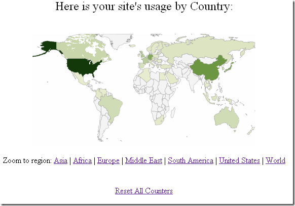

That section can be repeated once for each available region that Google will let us view (Asia | Africa | Europe | Middle East | South America | United States | World).  That then gives us something that looks like this:
As you can see, we now have a world view map that shows the heat of each country, and we have individual links that we can click on along the bottom to take us to a zoom of each country/region to get a more specific look at the info there.  As an example, let’s take a look at the data from Asia:
So we now have a nice little heatmapping application.  It pulls up a world view of app traffic going to your site or app, it allows you to click around to the different regions of the world to get a more detailed view, and it even lets you re-set the data at will.  I can hear some among you asking “What about the states, though?”.  If I take away the state view of the US and give a world view, then I’m really trading one limitation for another.  Ideally we’d be able to see both, right?
