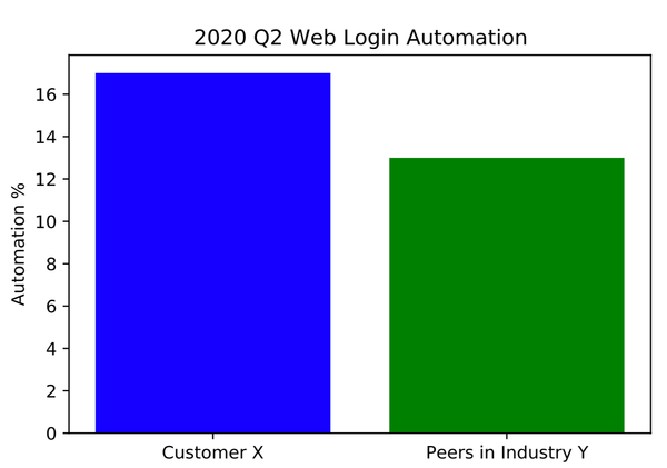

When we provide quarterly threat briefings to customers, an inevitable question we get is: “How am I doing compared to my peers?” The easiest way to respond to this question is to provide aggregated comparisons for specific application and platform flows. For example, we can tell Customer X that 17% of their 2020 Q2 web login traffic was automated, while 13% of 2020 Q2 web login traffic for their peers in Industry Y was automated. So, one option for a response to this question is neatly summarized in a bar chart.
Figure 1: Login Automation for 2020 Q2 for Customer X and Peers in Industry Y
Although this graphic is a stunning example of the basics of Python’s matplotlib, I’m sure all math lovers like me took one look at it and immediately asked: “Is this difference significant?” Aggregations have a sneaky way of hiding the details, and Customer X’s overall automation might be influenced by one or two massive attacks. To answer this question, we need to dive into what happened during 2020 Q2 to decide if Customer X really has more automation than their peers. And this answer is usually what customers actually want to hear, even if their question wasn’t: “What are the results of two sample statistical tests that you ran to determine whether our automation is statistically different from that of our peers?”

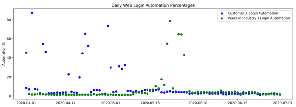

A natural way to compare all of 2020 Q2 for Customer X and their peers is to look at the data on a daily basis. So the first step is to acquire the daily web login automation percentages.
Figure 2: Daily Login Automation % for 2020 Q2 for Customer X and Peers in Industry Y

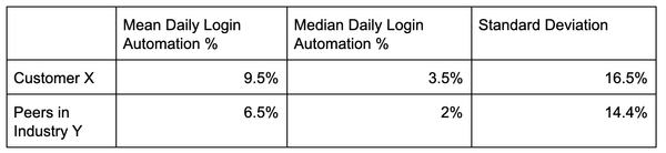

Automation tends to be erratic and unpredictable, and the scatter plot certainly reflects that. Both sample sets appear to have some outliers, but Customer X does seem to have more automation for the first half of 2020. Our next step is to review some summary statistics for both sample sets, namely the means, medians, and standard deviations.
In both cases, we can see the mean is influenced by erratic spikes in automation and the median automation percentage is subsequently lower. This result is further verified with a high standard deviation for both Customer X and Peers in Industry Y. But the similarity between those two standard deviations means it is reasonable to compare these two sets. More importantly though, Customer X has a higher mean and a higher median, indicating it’s safe to test this hypothesis. Whether we care about the mean or median specifically depends on what test we select, which is our next step.

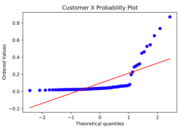

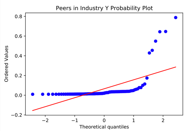

The basic statistical testing most of us are more familiar with typically assumes the data is approximately normal. I could expound upon what normal means for a long time, but that’s not the purpose of this post and I might accidentally start a war between parametric and nonparametric statisticians. For my work, I use two things: intuition about the data (usually supported by a scatter plot), and visual inspection of a probability plot. I intuitively believe daily automation percentages are non normal, and the scatter plot from earlier appears to back this claim. The stats portion of scipy provides a built-in function to generate probability plots, so we can easily inspect them for Customer X and the peer data.
Figure 3: Probability Plots for Customer X and Peers in Industry Y
These plots compare the quantiles of the two sample sets against the quantiles of a normal distribution. What we want to see, in order to claim the data is approximately normal, is a scatter plot that roughly falls around the best-fit line, shown in red. What we don’t want to see, in order to claim the data is approximately normal, is exactly what we do see: a clear shape to the scatter plot that is NOT on the best-fit line. The probability plots, combined with our initial idea about the data, indicate that we should not assume normality. As a result, we have to pick a test for non normal data.
