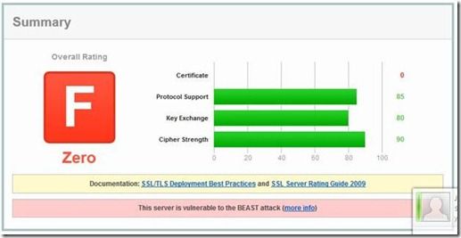

As a control test, here’s the report against a brand new apache2/mod_ssl site using all the defaults with a self-signed certificate. Let’s see how the analyzer grades it.
Okay, that definitely tells you something, doesn’t it?  I haven’t seen a grade this bad since I bombed out of Electromagnetism II in College.  The F in this example is given due to the fact that no one can really trust my site because the certificate isn’t signed by anyone that could provide proper third-party trust.  But apart from that, the latest Apache2 (2.2.14) is actually pretty tight.  Over 80 (B+?) for protocol support, key exchange and cipher strength.

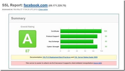

Let’s take a look at the world’s most popular (non-search) website.  How does it score?
According the analyzer, the Facebook site certificate is perfect and its crypto is grade A all the way.  I think the analyzer is taking points off because Facebook might be accepting client-initiated SSL renegotiations, which would leave a non-accelerated site vulnerable to the famous Renegotiation DoS.  Hardware acceleration mitigates that problem, as does this iRule.
