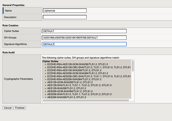

Step 2: Create a Cipher Rule

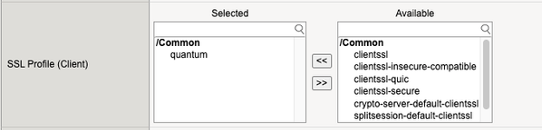

Step 5: Create a Virtual Server
Example:
tmsh create /ltm virtual quantum { destination 10.0.2.113:443 ip-protocol tcp pool quantumpool profiles add { quantum { context clientside } tcp } }

To ensure seamless browser compatibility during this transition, configure your BIG-IP to prioritize ML-KEM
Notably, the following cipher string did not work for me in Chrome as Kyber support has been removed in the latest versions of Chrome.
X25519KYBER768
As per the k Article.
Note: On June 24, 2025, Google released Chrome 138.7204.49 that no longer includes Kyber support. The chrome://flags options for PQC algorithms was also removed, and MLKEM is enabled by default.
My Chrome Version was Version 138.0.7204.158, so Kyber support has gone.
This DH cipher string worked for me in Chrome.
X25519MLKEM768
The K article recommends the following cipher string.
X25519MLKEM768:X25519KYBER768:DEFAULT
To reiterate. If you are using  anything earlier than TMOS version 17.5.1 and you attempt a test with a new version of Chrome, it will not work with ML-KEM as the support was only introduced in 17.5.1 and Kyber has been removed from Google Chrome, so if you were to test with 17.5.0 you would find that that Chrome would not be able to negotiate a quantum-safe connection.
As per the knowledge article.
