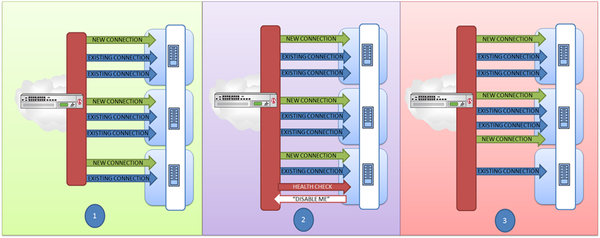

In phase one we have three instances of an application (physical or virtual, doesn’t matter) that are all active. They all have active connections and are all receiving new connections. In phase two a health check on one server returns a response that includes the string “DISABLE ME.” BIG-IP sees this and, because of its configuration, knows that this means the instance of the application needs to gracefully go offline. LTM therefore continues to direct existing connections (sessions) with that instance to the right application (phase 3), but subsequently directs all new connection requests to the other instances in the pool (farm, cluster).
When there are no more existing connections the instance can be taken offline or shut down with zero impact to users.

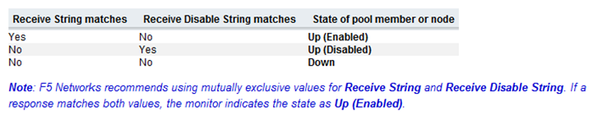

The combination of “receive string” and “receive disable string” impacts the way in which BIG-IP interprets the instruction. A “receive string” typically describes the content received that indicates an available and properly executing application. This can be as simple as “HTTP 200 OK” or as complex as looking for a specific string in the response. Similarly the “receive disable” string indicates a particular string of text that indicates a desire to disable the node and begin the process of bleeding off connections. This could be as simple as “DISABLE” as indicated in the above diagram or it could just as easily be based solely on HTTP status codes. If an application instance starts returning 50x errors because it’s at capacity, the load balancing policy might include a live disable of the instance to allow it time to cool down – maintaining existing connections while not allowing new ones. Because action is based on matching a specific string, the possibilities are pretty much wide open. The following table describes the possible interactions between the two receive string types:
