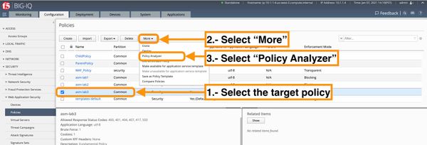

The figure below shows how to access the policy by
  • selecting the Configuration tab,
  • highlighting the Security menu,
  • expanding the item labelled Web Application Security
  • Selecting the Policies
The analyzer feature is available from the “More” menu as shown below:

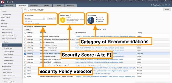

The Policy Analyzer screen provides the 4 main sections outlined below:
The Security Score shown above provides a synthetic assessment of the policy based on the severity and number of recommendations.

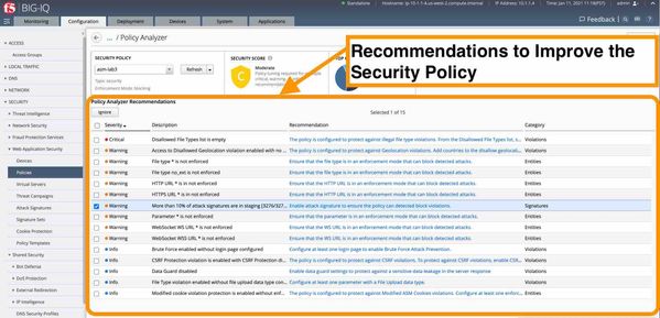

To look into more detail, refer to the recommendations table shown in the figure below.
From the screen above, you can select and choose to ignore the recommendations. You can also click on the recommendation to access the feature configuration screen directly. This will allow you modify the policy directly from the Analyzer screen. For example, clicking on the “More than 10% or attack signatures are in staging (…)” entry, points to the policy configuration screen shown below:
This allows you to review and hone your policy accordingly and adhere to recommended practices. Once the changes are made, makes sure to Save & Close  .
