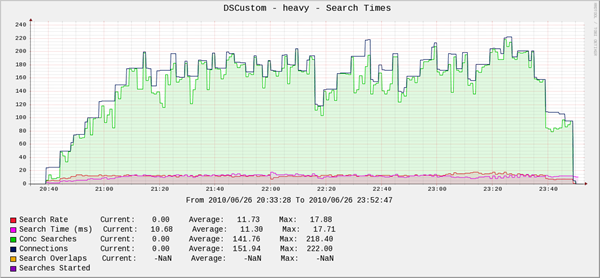

However, even keeping up with the scaling can affect us in times of exceptional load. When loads increase beyond the capacity of the service to accommodate them, we get the scenario shown in the graph below. A steady number of connections and searches from a high priority application shows a steady increase in search response times, and a corresponding increase in the number of concurrent searches over time.
The why is shown below. As more and more users attach to the service, we can see that performance suffers for those users that are regarded as critical to the organisation.

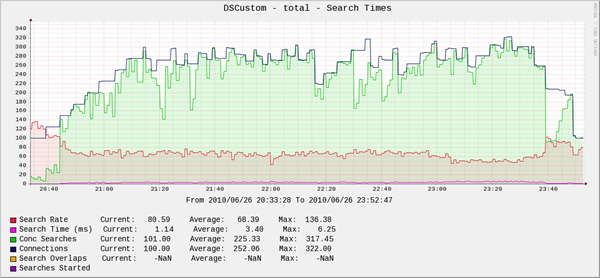

We can compare the ‘websso’ response time graphs for a similar increasing load when dynamic alterations of the load balancing are being made. Although the concurrent search count increases, the concurrent searches and search times remain constant for the high priority traffic (WebSSO) as the total load increases.

We can see as a result of the traffic splitting that the initial search rates start high and drop similar to the previous example as total load increases. However we can see that search rates then bottom out and remain relatively high, even as the total load on the system continues to increase.

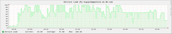

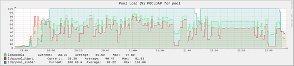

The pool load graph for the day in question helps to explain what’s happening here...
And in a more detailed version covering the same time period as the previous graphs we can see how the load is being shifted from the default pool (ldappool1) to the ldappool_sinbin pool. And how this keeps the load down on the ldappool_hipri pool
The dynamic routing of users to specific pools is being triggered by the calculated service load (Calculated from the load on individual nodes). The values used for this run being > 40% on ldapppool1 trigger to CRITICAL and < 20% trigger (On ldappool1) to NORMAL. Between 20-40% is a hysteresis region where the mode remains as it was (So for example on an increasing load 30% may be NORMAL while on a decreasing load 30% may be CRITICAL if the boundaries have been triggered previously.
