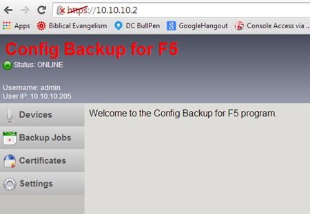

Once the appliance was configured and rebooted, I logged in to the web GUI. This is very straight forward and cleanly laid out very similarly to the F5 GUI.
The user guide goes through the user functions (devices, backup jobs, certificates) first, but I'd recommend configuring the settings first. In the Backup Settings, you set the backup time and the user name and password. This is important, as no device you add will be touched until this information is present.

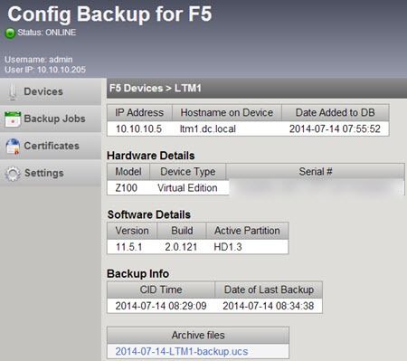

After updating the backup settings, I added my device.
I added/deleted a couple times before changing my backup time and I was wondering what wasn't working. It turns out the initial discovery of the device isn't done until the backup time occurs. I'd recommend in future enhancements to go ahead and do the device discovery shown in this screen and the Certificates screen when the device is added rather than waiting for the backup window.
