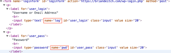

Let’s say you have login page without Application Layer Encryption.
If I were to right click on the Password box and choose Inspect, I would see something like this:
As you can see from the red boxes, the parameters for my username and password are log and pwd. We can all agree that this is in human readable format (HRF).

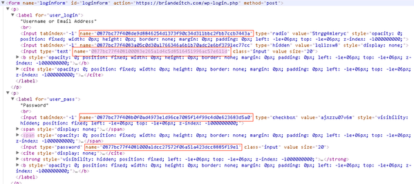

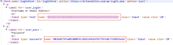

If I were to do the exact same thing with Application Layer Encryption, I would see this:
In the screen shot above there are 3 things I would like to focus your attention on:
  1. Both name=log and name=pwd are no longer in HRF.
  2. Notice in the first red box that there is a slight purple hue over the value? That’s the dynamic part of Application Layer Encryption. Every few seconds the values will change. This is done on the client side, not the server side. That value will never repeat and is completely unique to the user’s session.
  3. We also removed the element IDs, id=”user_login” and id=”user_pass”.
With Application Layer Encryption turned on, every user will have a unique value for name=log and name=pwd moving forward.
We can also turn up the security a notch by inserting decoy fields to further confuse the bad guys.
Decoy fields are only seen in the raw code and do not change the end users experience. As you can see above, there are additional IDs which makes it very difficult to pull apart in a replay attack.

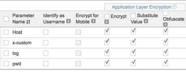

Step 2: Add the parameters you want protected.
The Encrypt checkbox is how we secure the username and password values that are being sent. By encrypting the values, this will prevent replay attacks as the values can only be used once.
The Substitute Value checkbox substitutes the parameter’s value with a random value in the web application while the form is being filled. This also prevents browser based malware from capturing keystrokes as they are being entered.
The Obfuscate checkbox encrypts the parameter’s name attribute.
