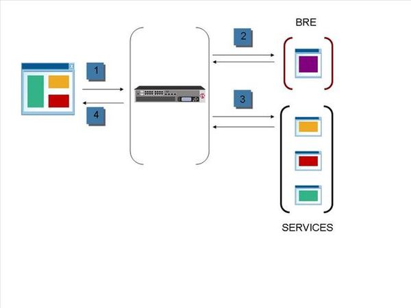

  1. The Process
  2. 1. The client sends a request.
  3. 2. Using an iRule, BIG-IP extracts the appropriate data necessary to formulate the query to the Rule Service and executes the query. This could be a SOAP request, a REST-based query, or some proprietary application format via a number of transport protocols, but most likey to be HTTP.
  4. 3. Using the response returned from the Rule Service, the BIG-IP directs the original request to the appropriate node in a pool of servers.
  5. 4. The response is returned to the client.
[diagram links to larger version of image]
Step #2 is really where all the magic happens, and is technically just an extension of the original scenario in which BIG-IP acts as a BRE. Rather than an iRule implementing the business logic that determines whether a loan request goes to a manual or automated process server, the Rule Service makes the decision, but leaves the actual act of routing up to the BIG-IP via an iRule's interpretation of the Rule Service's response.
