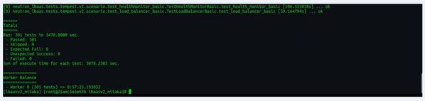

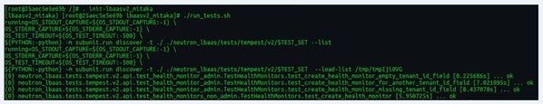

To that end, as part of the package development we created a test and troubleshooting Docker container, and have released it on Github here. This container bundles up all the software requirements and specific software versions required to run the community OpenStack tempest tests against any newly installed OpenStack Red Hat Platform environment. These tests let you know definitely whether the cloud was built correctly. We’ll run a set of test against your cloud installation assuring networking is working before we install any F5 service components. We’ll run a set of tests after we install F5 service components assuring the proper functionality of these services we provide. We’ll leave you with the test results in a common testing format as documentation that your cloud tenants should be good to go.  As we develop certified use cases of our technologies with our customers, we’ll write tests for those and run those too. Cool huh? This is DevOps after all. It’s all about tested solutions.
You don’t have to wait for our professional services to test your own cloud. By default, the test client includes all of the community tempest tests needed to validate LBaaS v2 on Liberty Red Hat OSP v8 (just for fun and to demonstrate the extensibility of the toolset) and Mitaka Red Hat OSPv9. Not only does it include the tests, and the toolsets to run them, get this, John even created a script which will generate the required tempest configuration files on the fly. Simply provide your overcloudrc file and the environment will be interrogated and the proper settings will be added to the config files. Again Cool. Testing is king, and we’re doing our best to hand out crowns.
