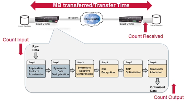

There are actually several cases where you will want to know about the maximum performance of an ADC, using the tools I pay the most attention to at the moment as an example. WAN optimization is a good one. In WANOpt, the goal is to shrink the amount of data being transferred between two dedicated points to try and maximize the amount of throughput. When “maximize the amount of throughput” is in the description, speeds and feeds matter. WANOpt is a pretty interesting example too, because there’s more than just “how much data did I send over the wire in that fifteen minute window”. It’s more complex than that (isn’t it always?). The best testing I’ve seen for WANOpt starts with “how many bytes were sent by the originating machine”, then measures that the same number of bytes were received by the WANOpt device, then measures how much is going out the Internet port of the WANOpt device – to measure compression levels and bandwidth usage – then measures the number of bytes the receiving machine at the remote location receives to make sure it matches the originating machine. So even though I say “speeds and feeds matter”, there is a caveat. You want to measure latency introduced with compression and dedupe, and possibly with encryption since WANOpt is almost always over the public Internet these days, throughput, and bandwidth usage. All technically “speeds and feeds” numbers, but taken together giving you an overall picture of what good the WANOpt device is doing. There are scenarios where the “good” is astounding. I’ve seen the numbers that range as high as 95x the performance. If you’re sending a ton of data over WANOpt connections, even 4x or 5x is a huge savings in connection upgrades, anything higher than that is astounding.
This is an (older) diagram of WAN Optimization I’ve marked up to show where the testing took place, because sometimes a picture is indeed worth a thousand words. And yeah, I used F5 gear for the example image… That really should not surprise you .
So basically, you count the bytes the server sends, the bytes the WANOpt device sends (which will be less for 99.99% of loads if compression and de-dupe are used), and the total number of bytes received by the target server. Then you know what percentage improvement you got out of the WANOpt device (by comparing server out bytes to WANOpt out bytes), that the WANOpt devices functioned as expected (server received bytes == server sent bytes), and what the overall throughput improvement was (server received bytes/time to transfer).
