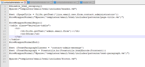

Figure 2: Jira Contact Administrator Velocity Template File

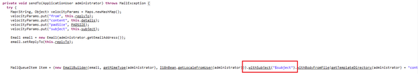

Before Jira was patched the subject field of the form was directly inserted to the template as a string and was not escaped correctly by binding it into a Velocity variable. This allowed anyone who submits the form to inject valid Velocity code into the template which will later be interpreted once the template is rendered.
Figure 3: Jira Contact Administrator unpatched Java code
