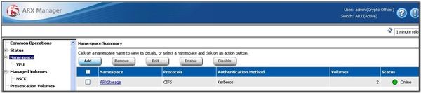

First thing you do is configure a namespace – a container for most of the other items you need to create. It holds publicly advertised shares and back-end filer shares, tells how to communicate with the filers and how to expect end users to communicate with you. It also holds the location that all shares are to use for metadata storage. My namespace is ingeniously named “ARXStorage”. The interface for the namespace is CIFS – I turned of NFS completely in this namespace because if it is included as a communications option, every NAS must have NFS access to every share. For simplicity, I disabled it. Some of our shares do support NFS, but we didn’t need NFS access through the ARX. And trust me, after the pain I went through with ADS, this device was going to use it.

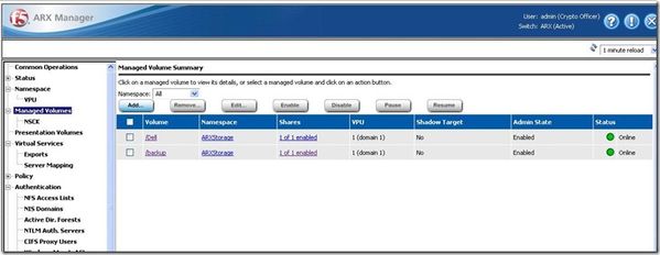

The Namespace then contains “Managed Volumes” – exports from NAS devices that are going to be (eventually) presented by the ARX. I have two of them in this configuration – backup (which maps to one NAS device), and Dell (which maps to the other). Lori and I normally immediately back up the primary to a new NAS when we receive one so that a single PDU failure doesn’t drop our storage environment cold. More on why I bothered to tell you that in a moment. First, the Managed Volumes in Namespace ARXStorage.
There you have it, not much to see. Currently neither is listed as a shadow-copy target, both are enabled and online.
These are shares the ARX is going to manage for us, The /backup share is mapped to /backup1 and is actually actively used – hazards of a growing and changing network – but the name is all over so I’m unwilling to change it. The /Dell share is the default share on Powervault servers - /NASShare.

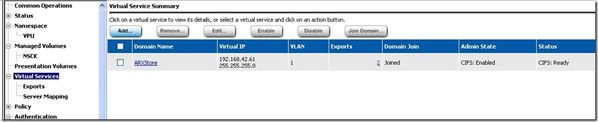

So we first create a Virtual. You don’t have to create a virtual first, you can just start defining exports and if there is no Virtual it will ask you to create one (okay, require you to, not ask, but you know). I’m showing you the Virtual first to keep things logically consistent and understandable. No matter how you create one, you must have the Virtual “first” or there is no way to export shares.
You will need an IP address for each Virtual you create. This is the entry point where users will access your shares – it masquerades as a Filer, in essence. Using my expansive wit, I chose to name this Virtual “ARXStore”. Note that it is already joined to the domain and is up and running. This screen shot was taken after all was configured.

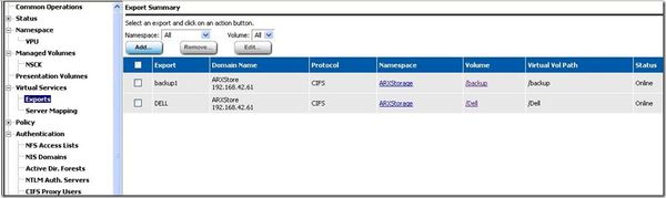

Finally, we are ready to set up the exports. These are publicly exposed shares and/or mount points. I’ve made mine all CIFS for the reasons noted above, and here they are…
So they have a “Domain Name” which is the Virtual name in the domain, what Namespace they’re in (which impacts which backend shares they can see), Volume and Virtual Volume Path. The volume is the backend share, the path is the path that it will present to users.
