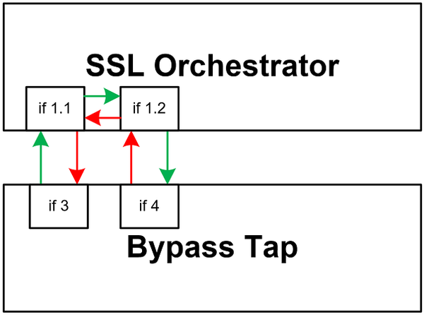

To check the status of the inline tools, the Bypass Tap sends health checks through the inline tools. What is sent on one interface must be seen on the other interface and vice versa.
So if all is OK (health check is green), traffic will be forwarded to the SSL Orchestrator, decrypted and sent to the IDS/IPS and the TAP, and then re-encrypted and sent back to the Bypass Tap.
If the Bypass Tap detects that the SSL Orchestrator is in a failure state, it will just forward the traffic to the switch.
This is the traffic flow of the health checks:

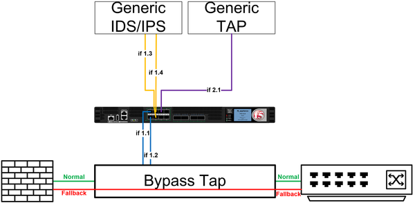

Target topology
This results in the following topology:

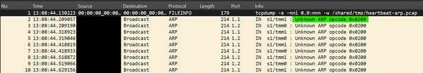

During commissioning of the new topology, it turned out that the health check packets are not forwarded through the vWire configured on the BIG-IP. A packet analysis with Wireshark revealed that the manufacturer uses ARP-like packets with opcode 512 (HEX 02 00). This opcode is not defined in the RFC that describes ARP (https://datatracker.ietf.org/doc/html/rfc826), the RFC only describes the opcodes Request (1 or HEX 00 01) and Reply (2 or HEX 00 02).
NOTE: Don't get confused that you see ARP packets on port 1.1 and 1.2. They are not passing through, the Bypass Tap is just send those packets from both sides of the vWire, as explained above. The source MAC on port 1.1 and 1.2 are different.

The following topology was used for the lab:
I build a vWire configuration on the SSL Orchestrator, as in the customer's environment. A Linux system with Scapy installed was connected to Interface 1.1. With Scapy TCP, UDP and ARP packets can be crafted or sent like a replay from a Wireshark capture. Interface 1.3 was connected to another Linux system that should receive the ARP packets. All tcpdumps were captured on the F5 and analyzed on the admin system (not plotted).

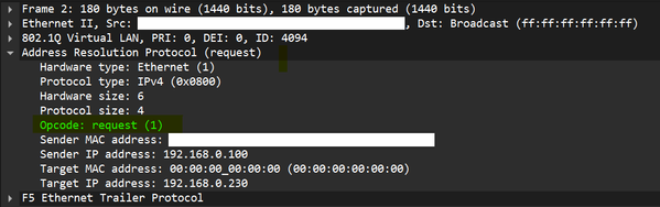

To create RFC-compliant ARP requests, I first sent an ARP request (opcode 1) through the vWire via PING command. As expected, this was sent through the vWire. To ensure that this also works with Scapy, I also resent this packet with Scapy.
>>> sendp(rdpcap("/home/webserverdude/cusomter-case/good-example.pcap"),iface="enp0s31f6")
Sent 1 packets.
In the Wireshark analysis it can be seen that this packet is incoming on port 1.1 and then forwarded to port 1.3 through the vWire.

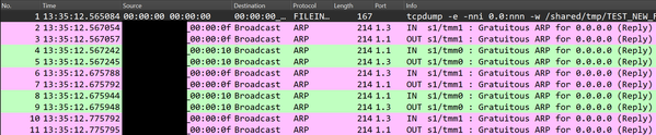

In this Wireshark analysis it can be seen that the Healthcheck packets are incoming on port 1.1 and then forwarded to port 1.3 through the vWire (marked in green) and also the other way round, coming in on port 1.3 and then forwarded to port 1.1 (marked in pink).

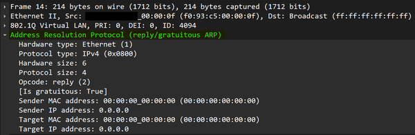

Also now you can see that the packet is a proper gratuitous ARP reply (https://wiki.wireshark.org/Gratuitous_ARP).
Because the Healthcheck packets were not longer dropped by the BIG-IP, but were forwarded through the vWire the Bypass Tap subsequently marked the BIG-IP as healthy and available.
